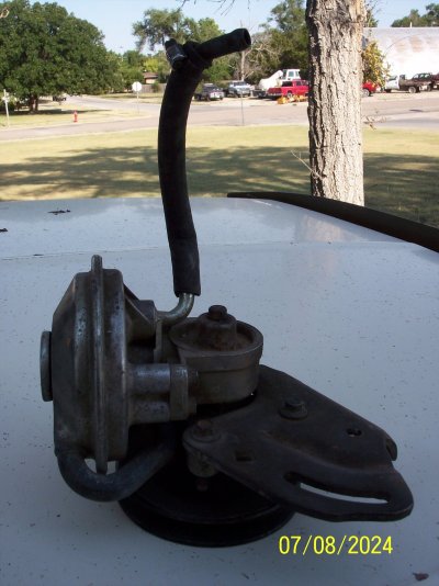

1. Does the "pod" from later model ('97 PSD) vac. pump really bolt up to the 7.3 IDI pump drive assembly?
2. If so, did (how) you manipulate the vacuum port to point the right way?
Yes it does. Here's my solution to your second question. I cut the elbow off of an old pod and used a piece of 3/8" fuel line to connect it to the PSD pod. This one also makes about 10-12" of vacuum. I carry it around for a spare since it will still make enough vacuum to stop the truck.
Much appreciated sir.
Maybe my gauge isn’t right (OTC). It’s reading almost 12”…good for one press of the pedal.
Maybe my method of brake application is flawed. I’m the “light engagement, release, engage again” fellow…12” doesn’t support that method.
The second press is a “no assist” scenario.

Mine depends on how long I wait before pressing the pedal again. I usually just press once. I did say it's a spare. That means to be used in an emergency just until it can be replaced. Your gauge is probably fine. This particular pump would only build 16-16.5" even when new. I had to use it again last fall after it's replacement blasted a bearing out of the drive unit like seems to be the trend these days. The one that I'm running now is an old one that I've drug around for over 15 years. I dug it out of where I had hidden it, it seemed good. I installed it and it's been great so far.
