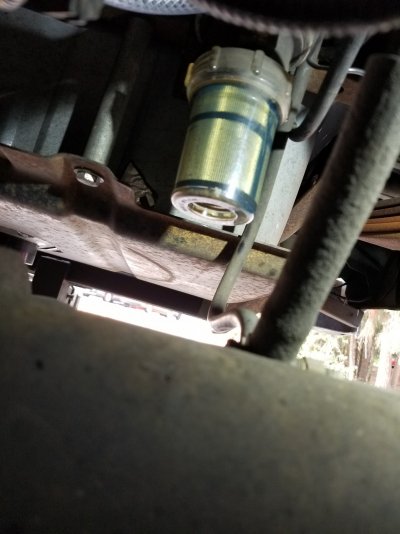

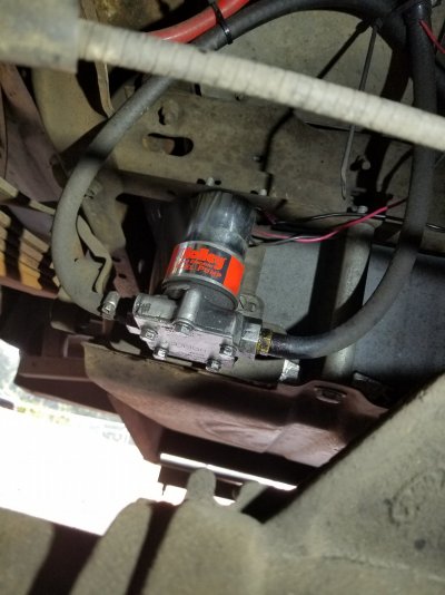

Fixed my fuel system. My truck died yesterday while driving my Holley fuel pump quit running, come to find out it was my blade type fuse holder. I had mounted a facet fuel pump to use has my pre filter for the Holley, so I wired it up with a switch in the cab, for a back up fuel pump.
