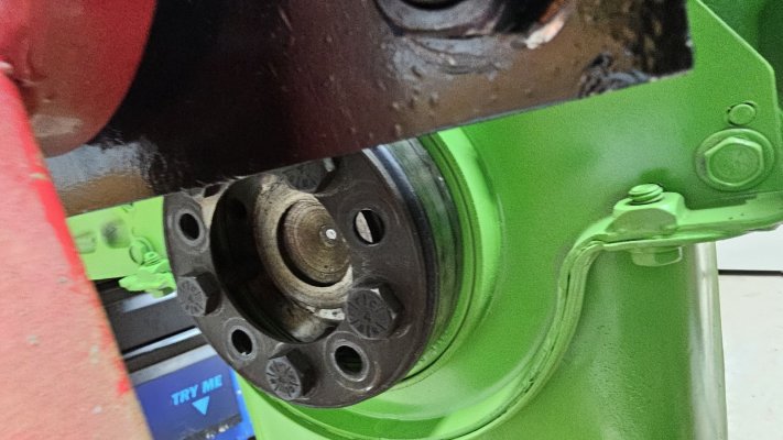

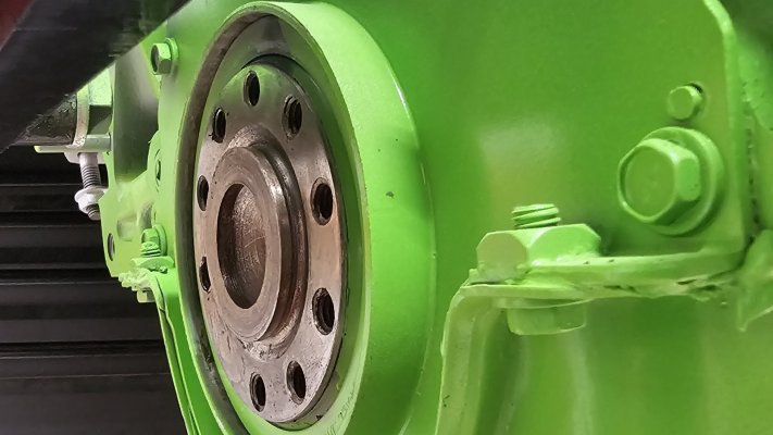

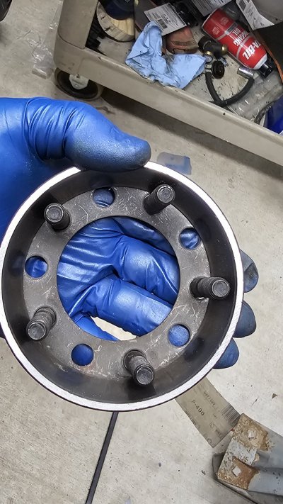

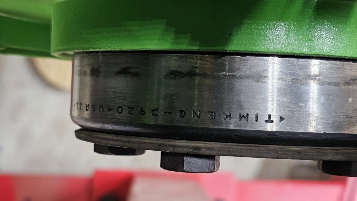

I think there is an old saying that goes something like "Stupidity is the ugly step sister of Necessity but Necessity is the mother of invention" Pretty sure that's how it goes.
So the stupidity in this story is not double checking the depth of the rear main seal before assembling everything else to it. When I removed the install sleeve it was obvious I had not pressed it in far enough.
I couldn't use the piece of wood I had cut to press it in when it was off the motor. Luckily I have a habit of never tossing out old parts. Digging through all my round ring shaped parts I found an old Timken 3920 Bearing Race that was a perfect size ( wish I had figured this out when was putting it in in the first place) So I used it and some of the flex plate parts to push it in to the correct depth. So the moral of the story, sometimes stuff you scratch your head wondering" Why am I keeping this stuff?" Finally shows you why lol

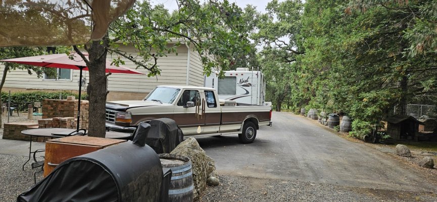

1.35 acre...
It's a curse and a blessing..
The pit bike track is to the left.
The house is out front.
