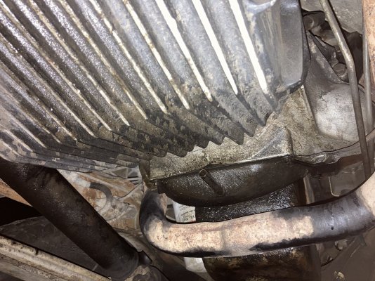

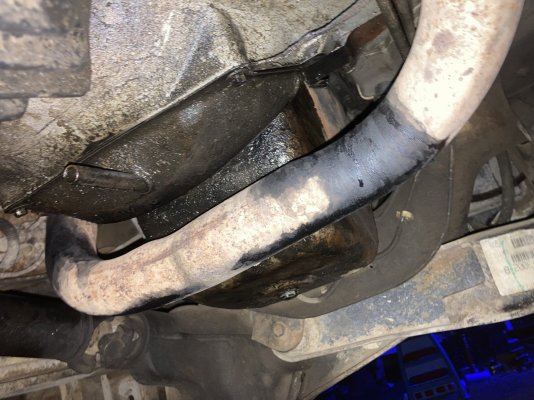

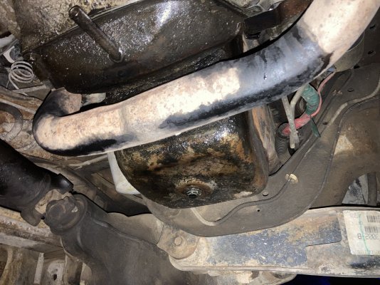

This doesn’t look right to me but I’m still fairly new to these engines. I know they usually seep oil but obviously there’s quite a bit. Should I be concerned? I haven’t noticed any smoke at all from the exhaust and I always keep a close eye on it because this is my daily driver.

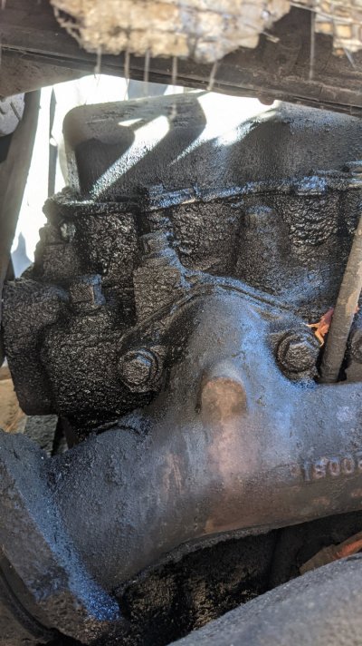

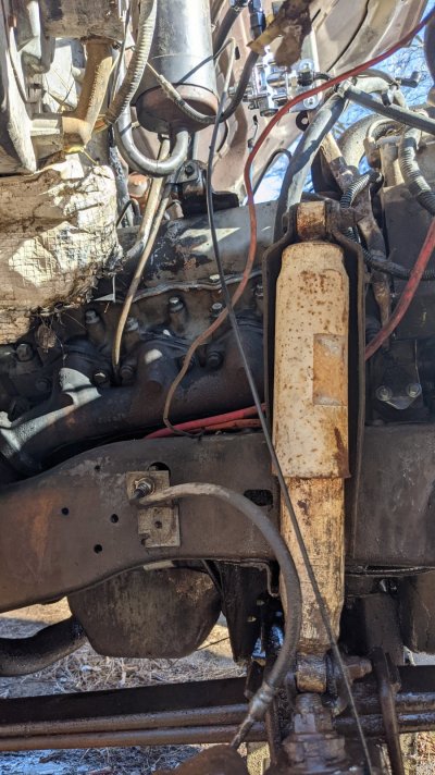

Check your valve covers and CDR valve on the back of engine behind the air intake. They are notorious for leaking. My truck leaks the same way right into my exhaust pipes and I pinned it to the valve covers. For me passenger side rear. On my photos you can see how dirty and caked they were, then see the leak after it's cleaned off.
