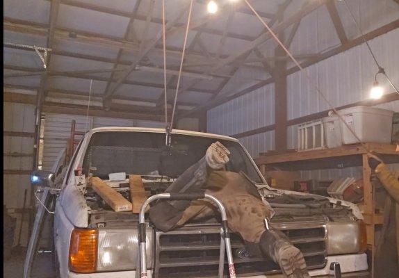

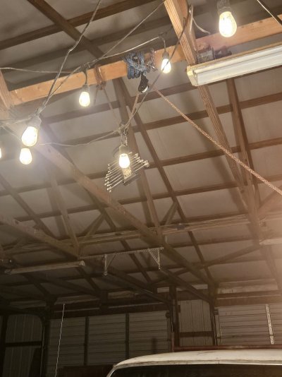

Figured I'd update. Ive been able to work in neighbors' barn, out of the weather. Big change from working on the inch and a half gravel driveway. Got everything down and cleaned on the way, head bolts loose and ready to pull in the morning. My friend set up some rigging in the trusses to help me lift it out of the truck.
Getting the head bolts loose was funny, had to stand on the frame inside the engine bay to get enough leverage on them. Glad Im as small as I am.

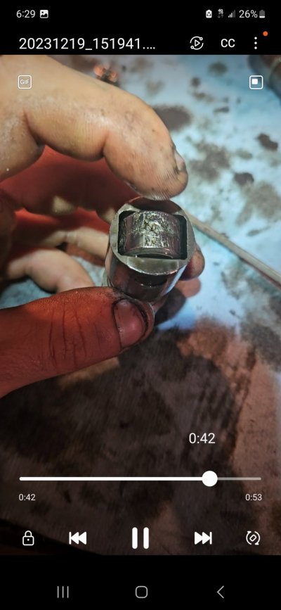

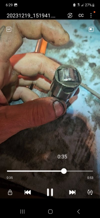

Going through my lifters, taking them apart and cleaning them up before putting the valley pan and intake back on. Looky what I found. Had a flat spot on it so I kept turning it and the rest of the roller suuuper messed up. Maybe thats what made the initial noise I heard from back there.
From what I can see through the hole in the valley, the camshaft somehow doesnt look messed up. I know flat spots happen when the rollers stick but I wonder what caused that horrible pitting. Any thoughts?

Probably just got stuck. Did your truck ever sit for a long period of time?
Even still, I can’t seem to keep lifters in these trucks. But I keep them absolutely screaming… Had to do lifters on my 6.9, as one started ticking. A little while later I blew a head gasket, and found one head to be warped completely out of spec. So I 7.3 turbo and 5 speed swapped my 86 Bullnose, and never looked back. Whole different truck after that. Still needs quite a bit of work…
I currently have a ticking on my 7.3 which is a very light, almost clicking sound. Not like a glow plug controller though, which I don’t have anyways…
I am at this point convinced it is an exhaust leak, I have dug into the exhaust some, replacing manifolds, but no luck with that. New injectors. I have noticed that it doesn’t tick with the engine cold… and it doesn’t always tick… but usually it does, if the engine is warm. Never when cold though…
And I put lifters in it, at the time thinking it might be a lifter tick. I was evidently wrong. Lifters were one of the few things I did not replace in my engine, when I half-ass rebuilt it. But anyways, I found one lifter to have some scratches on the roller, and a hard spot in the roller… so I’m still glad I replaced them. I soaked the new lifters in oil for a month (only a few days is necessary) before putting them in the engine.

Oh yeah, bud. I just went through all of rhe lifters for the passenger side bank, took them completely apart for cleaning and reassembly. Luckily that was the only one in bad shape.
Going to go through the drivers side tomorrow. More and more glad every day that I got that parts motor.
