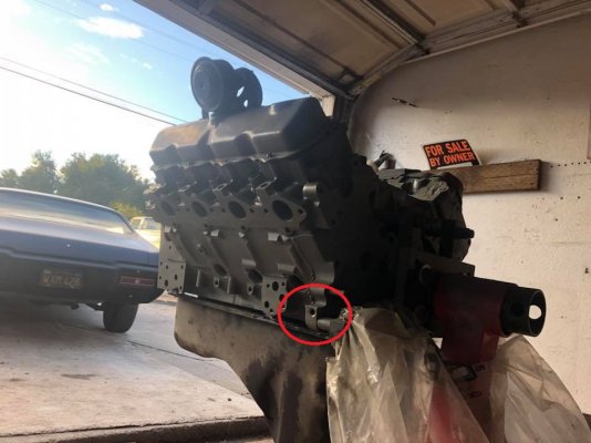

weld a nut to it.
12,367
11,106
It takes a 9/32" square socket to remove that plug if it's the one that was put in at the factory. A 12 point socket might work too. At this point, neither one will work since it's been damaged so badly.
