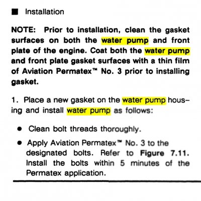

Can I get yalls thoughts? I got a felpro gasket set for the water pump and front cover. Manual says to use aviation permatex, fel-pro gaskets come with blue sealant on them already. Do I add the permatex or not? Never been clear on what to do here. Im inclined to just follow gasket manufacturers instructions but I have no idea.

Just the gasket is fine, but I put stuff on it anyway.

I like to put a thin coat of RTV, any kind, on both sides of the gasket or on one side and the surface that will contact the other side. I don't do this for sealing purposes, but it makes it much easier to clean up the next time that you remove the gasket/water pump. Gaskets have a bad habit of acting like they've become part of the metal after so many years.

Im talking about this part of the '91 engine service manual. Felpro says install dry, ford says permatex film so I wanted to get opinions and experiences. Things have changed since '91, Im sure LOL
Thanks yall. Im down to do whichever, as long as it doesnt leak in there. I dont want to do this again for a while. Also got a killer deal, got the front cover gaskets, lift pump gasket, an oil seal, and the water pump gasket for $4.44.

I have never had to do a water pump on an idi yet but on the powerstroke and on gassers there are a few bolts that go into the water jacket that can leak without sealant applied to the threads.
On the gaskets, if they are paper I coat both side of the gasket with wheel bearing grease. If your surfaces have any pitting I would recommend using a silicone sealant though.
James
I'm 85% certain that the top 2 bolts are like that.

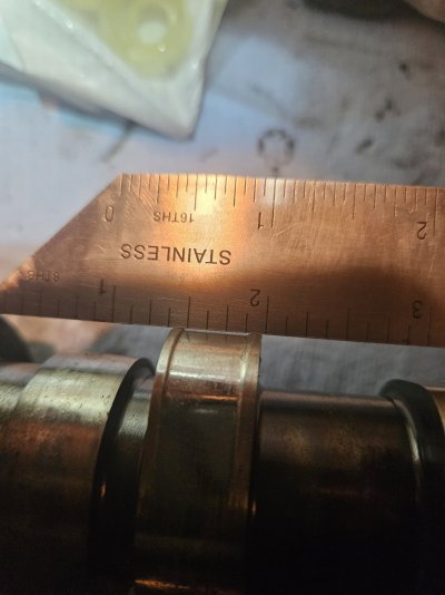

Cams are switched out. Figured yall would want to see the carnage though LOL You can almost measure that gap with a ruler. The first journal on the shaft had a really big series of pits in it too.
Really glad Im digging in this far because the water pump gasket had failed into that blocked off cavity on the back of the pump and the four bolts had zero thread sealant on them.

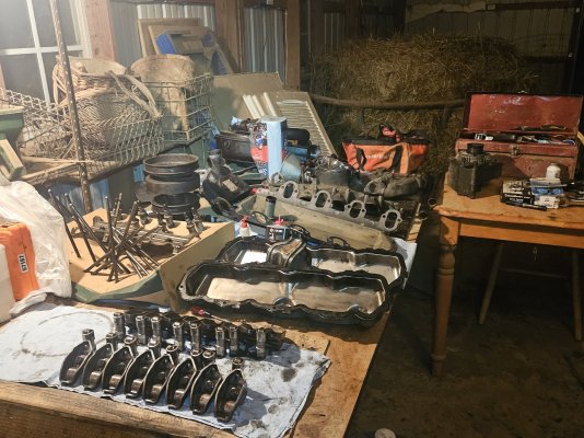

It looked as good as I could tell without a micrometer. Everything was bright and smooth, no pits or buildup after cleaning. Just some staining and the tracking from the rollers. Journals went through the bushings nice and tight and there didnt seem to be any play once they were all in. Very relieved and now I know a lot more about this engine LOL
Getting everything cleaned up tomorrow to go back together. I haven't ever had this many parts off an engine before. The collection is staggering lmao
That’s a good deal. How are your valve cover gaskets?
Basically brand new and I even have a backup pair that came with the head gaskets lol
