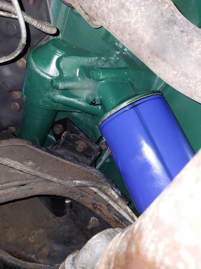

Hey guys I just got done doing a reseal on my 7.3 idi, but after putting the engine back in the truck I noticed a weird oil leak. It's coming from the oil cooler rear head on one of the bolts. Here is a photo, I did confirm it's from that bolt only and both from above it or the oil filter.
Why is this leaking here? Does this bold need to be rtv or have thread sealer? I used the OEM style dorman gaskets when installing the oil cooler to the block.

I don't know if they require sealant but I've always reinstalled mine with the Right Stuff gasket maker on the threads.
Back that bolt out, clean it and the female threads with brake cleaner and reinstall with RTV.

Gasket may have failed between the oil cooler passages and the bolt hole. RTV on the threads may not fix it.

I'll try cleaning and using rtv on the bolt, and if that fails looks like I get to redo the oil cooler gaskets. fun times for me

I know I did not use any thread sealant when I rebuilt my oil cooler. Just paper gaskets held in place with Hi-Tack. I was amazed I managed to properly clock the two ends, keep the gaskets in place, support the assembly with one hand while blindly threading bolts, and not have any leaks--that was a long Saturday if I recall correctly.

I decided to just replace the gaskets and did the orings at the same time. Everything is good so far with no leaks. I do have a somewhat unrelated question. What could cause my oil dipstick to read incorrectly? I put in 11 quarts of oil (using FL1995 filter) and it says I'm still 2qt low. Could the new rtv from the oil pan be pushing the stick off course? I have it installed correctly with the holding bracket.

Probably the gasket. Using Hi-tack seems to be the best way to hold em in place and its good at holding a seal even after disturbing the gaskets and moving them several times during install while wrestling the damn cooler into place. but sometimes, we mess up and it doesn't seal and we have to do it again. I've resealed dozens and dozens and every now and then, I gotta go back and do it again. if its not a bad leak, I usually wait till the next oil change when the filter is coming off anyways....or if I plan on dumping the coolant for something else. I try to kill a few birds with one stone if possible.
