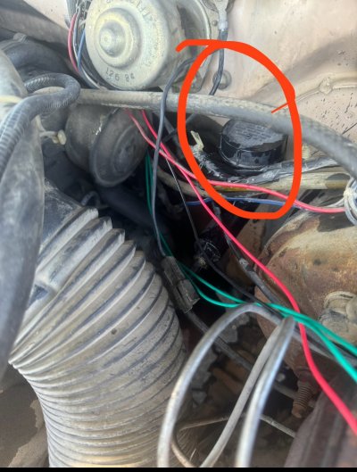

The master cylinder looks pretty rusty & original, I did not check fitment of the fasteners. I did open the lid for filling the slave cylinder & it was full of oil still. The oil around the cap is my doing, I took the black plastic sleeve out and it was sitting in the oil.

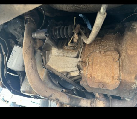

I took at pic of the slave cylinder when I was under but did not check for fitment (did not know what I was looking at until now). I think it was replaced sometime recent? It looks newish compared to the rest, also not sure how they should look normally (white plastic piece looks funky?)

The white plastic is a socket /bushing for the pushrod to clutch arm socket. Sorta like a lubricant.
Grab the cyl and see if its loose, it should have a tiny bit of flex (1/16" ish) not 1/4" ...

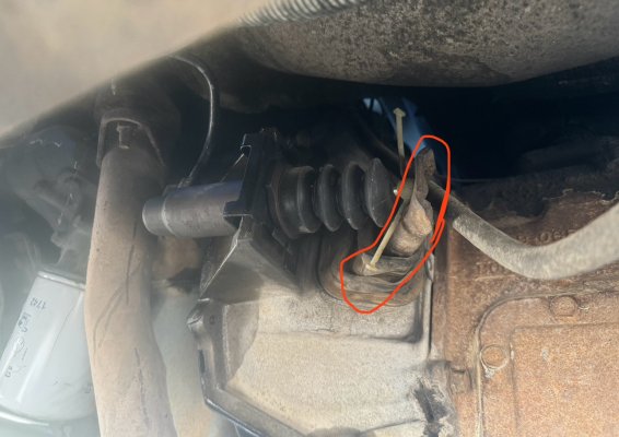

I’m going to do some research and see what looks normal, so I can compare & see how the cylinders move when the clutch is pressed in, does the slave push the arm here (check attached photo where circled) and this did engages the clutch?

Bullnose guys...
Is that the right slave cyl.???
Does the length of the throw on that last pic seem long?
The clutch fork usually rests @90 deg to crankshaft centerline longitudinal like?yes?

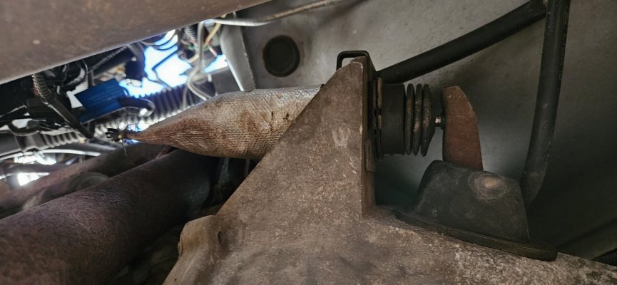

Here's my 93 for comparison.
Notice that the rod,clutch fork,and cyl. Housing are all square at 90 degrees to eack other...

Looking at the two pictures of Ralph's and Clb's slave cylinders, it's pretty obvious that Ralph's is sticking out almost all the way. I'm not saying that it's a wrong slave cylinder, but something's causing this to happen.

Try this...
Hook up your bleeder to the slave cyl., then crack the bleeder, then try and shove the pushrod back into the cylinder all the way in.
If it goes in smoothly good.
Careful about the pressure plate tension.
Rebleed and test.
If it's notchy it probably extended past the throw and needs removal and reassembling.
