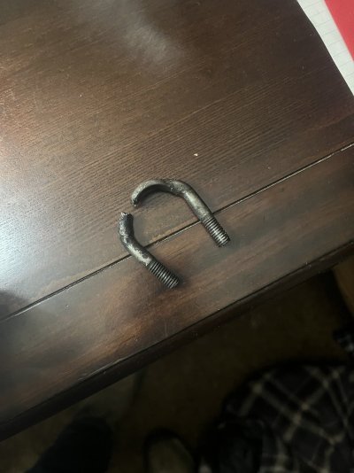

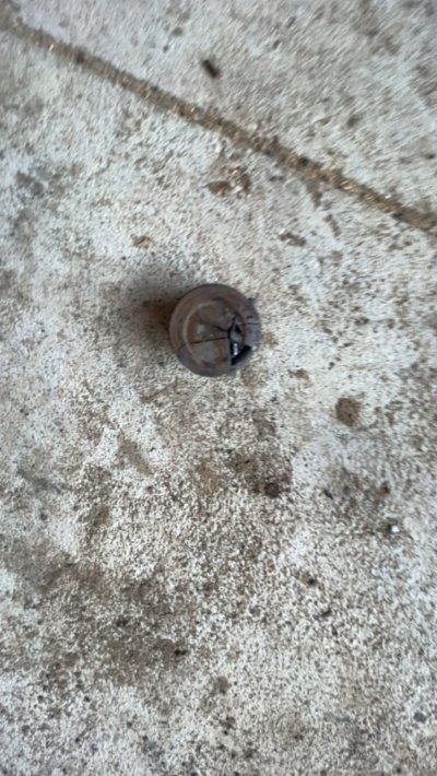

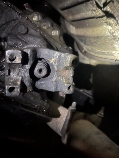

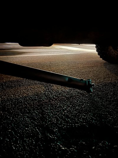

Alright, at a loss for words tonight
86 f-250 6.9T t-19 2wd carrier bearing drive shaft
Back in August I shattered the front u joint cap thought it was one off but tonight I sheared the strap
Both times where 3-4 down shift
After the first failure I put in a slicer u joint and I am meticulous about inspecting it every sunday and greasing it every 2500 miles
So I knew as of yesterday the straps where tight
I’m going to take the driveshaft to a driveline shop to have it fixed as it’s pretty dented now but fear there may be an underlying issue here

Are the little ujoint cap 'stopper nubs' still in the yoke? If not, the caps will work themselves out. Is there fore/aft endplay in the trans? (Pull yoke in and out)

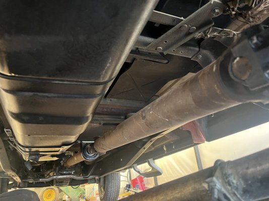

Is the d/s support bearing inline with the trans and pinion? (Laterally)
I suppose the shaft is bent now... but was it already bent?

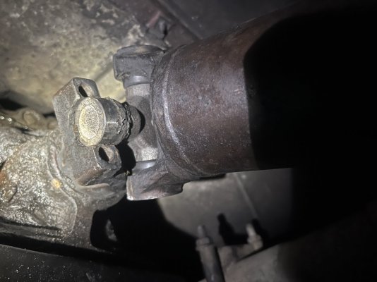

Most repeat failures that I have seen when u bolts are involved is overtightening.
Is this 1330 series, and if so, ford almost always uses the big cap 1330 in positions with a u bolt yoke.

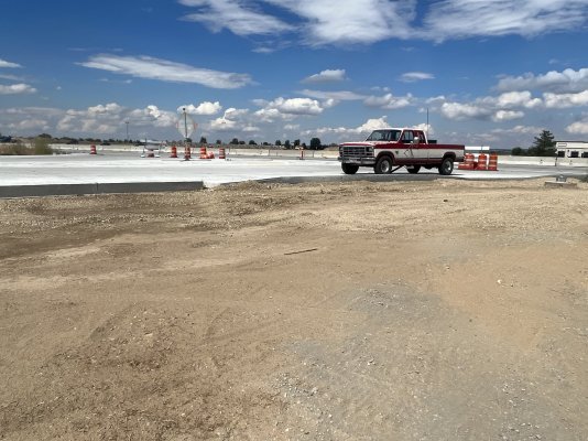

Old picture before any damages
But shows how good the angle is

Heard perhaps it’s a yolk issue?

What part number is that u joint? Doesnt look like any spicer joint I have seen.
Are the caps bigger where they bolt into the trans yoke vs the driveshat ears?
Austin86250
Oct 5, 2021
839
486
idaho
Oh no that u joint is my spare I had to throw in
they are the same size

From what I can see in the photos everything looks pretty good. If everything feels and looks good, my guess would be that the ubolt had a stress crack that just gave up.
Could have been caused by the previous driveline failure or years of being over tightened or not evenly.
You would be amazed at how many of these I have worked on that people only tighten one side. The nut will be flush or less on one side and they draw a 1/4" through on the other side. If that has been done repeatedly it will cause cracks in hardened fasteners.
This may not be the cause but something to consider.

I'm with the stress fatigue crowd on this one...
Those U-clamps can take only so much before they will yield...although it is surprising how much they WILL take...and not give you any indication they are stretched...unless you measure them before and after...
And...it is possible to crack a cap by over-tightening...
I don't know what is the recommended torque on those...but...if it is a 5/16" on the threads...I would estimate around 25 lbs-ft and no more than 27...
X2 on the 'evenly' pulled up...but I am kinda persnickety on that sorta thing...

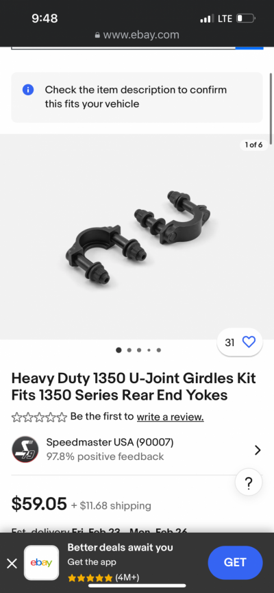

Y’all think these straps are over kill or a good idea?
