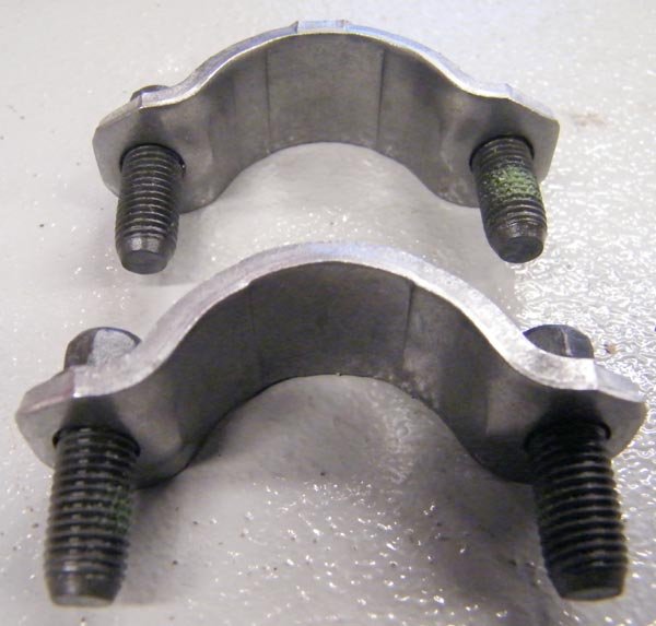

Y’all think these straps are over kill or a good idea?
For what it's worth I've seen some of these parts on Bronco graveyard for a bit cheaper than elsewhere (the one linked below is $7)- not positive on your truck's specs but this strap kit seems more reasonable than the one pictured above

Straps and u bolts are specific to the type of yoke being used. Not interchangeable.
Is this 1330 series or 1350 series u joints? Looks like 1330 series. If so, need to make dang sure that it doesnt require the big cap 1330f in that position.
If I remember correctly, u joint u bolt nuts are under 20 ft lbs. Pretty easy to distort the cap, which is why ford came up with the big cap 1330.

I can always get at ujoint strap bolts with a socket and wobble extension. Might have to clock the shaft around for better angle though.
The straps and bolts can be bought at rockauto or wherever you buy ujoints.

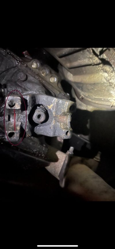

Is the red line I drew what is needed for a u joint cap measurement?

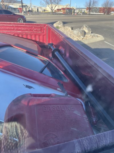

$900 later I got a new driveshaft only thing left saving was the slip joint and rear yolk
They said that the strap failure is extremely rare and must’ve been a result of reusing the straps after the first failure back in August
