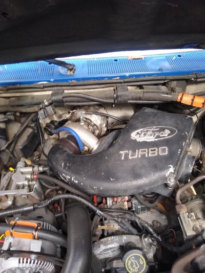

So the day finally came. I bought a stock 93-94 airbox because I'm not going to go and try an aftermarket setup at this stage of the game. I need the truck for work and I have no time to putinto this anymore.
So I took her out for a test drive and man is she quiet. It used to drone being that it's straight piped. Now I can hear the radio woo hoo. So seat of the pants tells me it has gotten quicker, but now shifts earlier. I used to be able to chirp the tires, but now it shifts to 2nd so quick. So as far as boost goes I seen it get to 3 psi when I got on it. No smoke or anything . So for the shifting I'm thinking maybe adjust the tps. I'm going to test her out tomorrow by getting g a 5 ton load of stone in the trailer and see how she responds. Thinking maybe turn the fuel up?
What’s the max boost you’ve seen?
