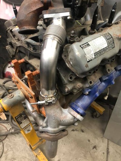

when your factory/093 up pipe leaks like a siv,
ive got the answer.
The up pipe I have is locked together. I don't want to mess with it. we will see if it stays together as I go along. If I have problems with it I'll keep you in mind. Going to start pulling the exhaust off today. Need to find some kroil first, or something similar. Russ, I'll be ordering the turbo return lines today. Also found turbo blankets on amazon.
