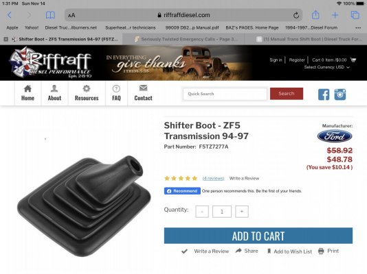

Does yours look like this?
There is also an inner boot.

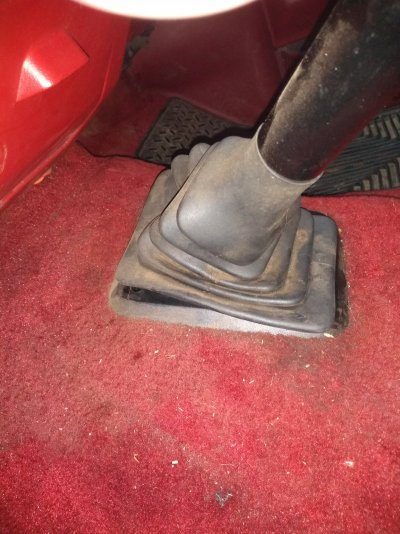

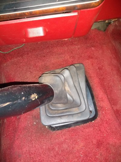

Update. Boot looks ok, looks like it pulled out of the ring.
12,410
11,154
If that's all that's wrong, you can unscrew the ring and tuck the boot back underneath the ring.
