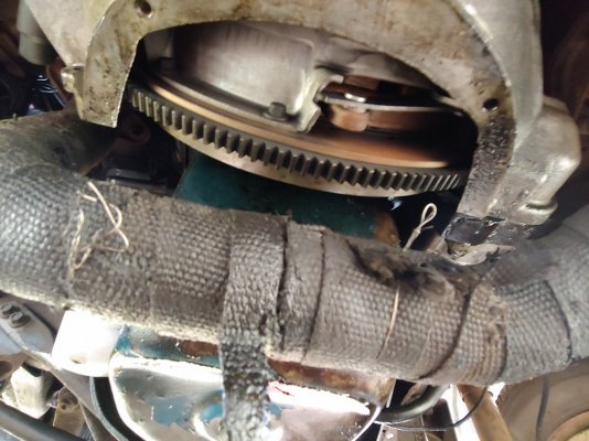

I unplugged it and it made no difference. But I think I found where the rest of the noise is coming from. Here is a video. The noise is coming from the clutch/flywheel area. I was told by the previous owner that it was all replaced and upgraded. The clutch definitely looks spanking new but the flywheel not so much. can anyone tell from the picture if this is the problematic noisy flywheel I have heard about?

Thanks for letting us join you in on your idi and oilburner.net learning. I hope it doesn't sound unhelpful that you could familiarize with the forum and do us the courtesy of saying "advance the video to the ___ minute mark", since we just read what was your point.
Also meaning to be of help:
Injector imbalance/faults can make the noise as you describe. Injectors are removed and pop tested at an engine shop.
The noise of a solid flywheel retrofitted idi can be considerable but that should go away when the rpms rise above idle.
