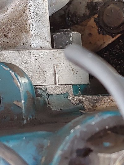

so to me this looks very very retarded on timing. am I looking at the right marks?

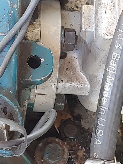

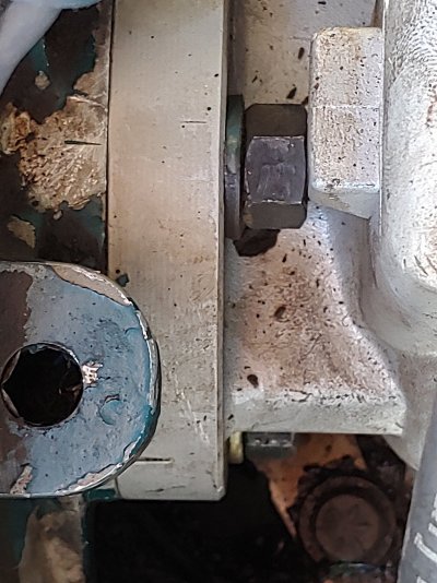

okay I am now very confused. it looks like there are 2 sets of marks. the picture above is on the driver side of the pump. these smaller marks are on the top of the pump. the marks on the side look to be very very retarded and the ones on the top look to be very advanced. what set of marks am I using?

Unfortunately the marks are only ballpark to make it run. It needs to be timed with a meter. That being said you can adjust it to see if it improves. Put a set of marks so you can return it to where you are now. Adjust your pump a dimes width at a time (this is about 4 degrees). Towards passenger side advances, toward driver side retards. You want it right on the edge of powerstroke rattle if that makes sense. I used to set mine to where if I energized the advance solenoid it would rattle, when I deenergized it quieted.
Do not adjust ip with engine running.

Sounds advanced to me and interesting to hear that it’s clattering all over that’s why I asked about pinpointing. In your one pic it looks like the one set of scribe marks is like a dime and a half towards the passenger. Turn that back to where they are lined up and see if it changes the sound. I’ve turned my IP on one of my engines like two dimes passenger side to see what it sounds like at different points and it sounded similar. That was before I got a meter. You need someone with a meter.
