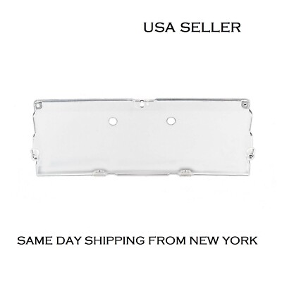

I see you put a pickup cluster in your van to get the factory tach. Looks great!!!
I just grabbed one from a ewe-pull-it. Although I think the pickup spent most of its life driving through fields. It’s super dirty and the plastic cover is cracked. Oh well, goes with my beater.

They sell new clear lenses for pretty cheap.
