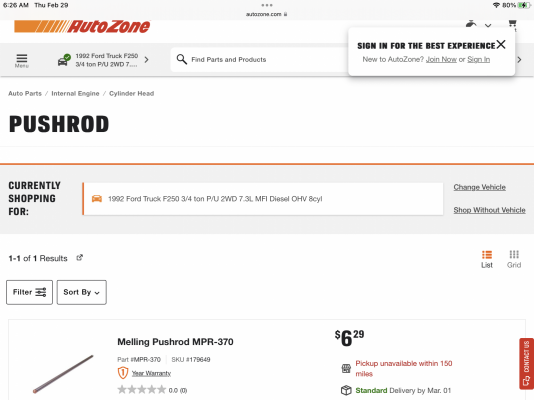

I suspect a bent push rod from the usage of ether in a diesel engine.
The other option might be bending a conn rod. Now if I pull the V/C, remove the push rods, roll them around and if I find no damage, then the next step might be in the conn rod inspection. Impressive is that this engine currently has about 7K miles since installation. Not my daily driver and I am about to order up some HP increase chunks. It runs out fairly well, it could be better.
I will probably take a hose to the V/C and listen for a tick. if I do not find a tick, a comp check will be next. I really do not desire to pull both sides V/C.
Now if memory was working, I could have sworn I installed a set of upgraded push rods. The next step up is roughly $389 a set. However, I have no future plans on ether or running that large a HP increase to warrant $389 push rods.
