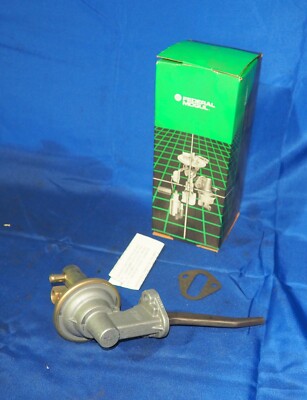

Been doing a Google search for the past hour on the mechanical Lift Pump, E3TZ-9350-B.
I found 2, 6 - 8 months ago searching. Online dealer showed having one, but discontinued or out of inventory. Called their #, and the Parts guy did some searching and gave me the #`s of a couple dealers that showed stock.
Finally found 2 NOS OEM that had been on the shelf for a while. Think one was in Florida and the other in Michigan.
Some times dealers sell on E-Bay to clear out inventory.
This guy has NOS, but how old? Was it before off shore started to come onto our shore?
Not a bad price.
I wonder if there are other Ford Trucks/Cars that use an electric Fuel Pump that might work that are OEM/NOS?
Found this site, interesting all the stuff they handle, but the part# F3TZ-9350-B comes up,
be interesting to contact them.
I didn`t search the Holley Pumps though.
Maybe I`ll do that for fun.
