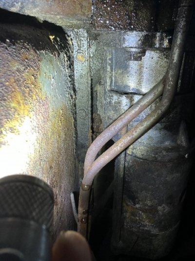

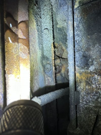

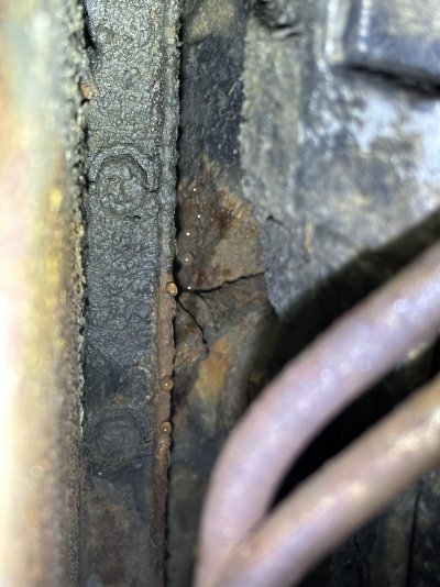

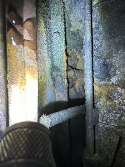

Possible this is what happened. This truck came from Eastern Oregon.
It’s hard to get photos but here you go.
Only actively leaks while running

Sorry those are the best pictures I could get. Upon second glance that actually might be around the block heater. Passenger side there’s a stainless steel plug to the right of it and a wire for what I thought was a sensor to the left but might just be the block heater. I’ve never seen one, I expected them to be big blocky contraptions
I would start with pulling the starter out so you can actually see what's going on. I really can't tell exactly what in looking at in your pictures as the starter is hiding everything.
If what looks like a crack in your picture is actually the crack, it looks pretty bad. I have never seen one crack all the way down to the pan mounting surface without some help from internal parts.
