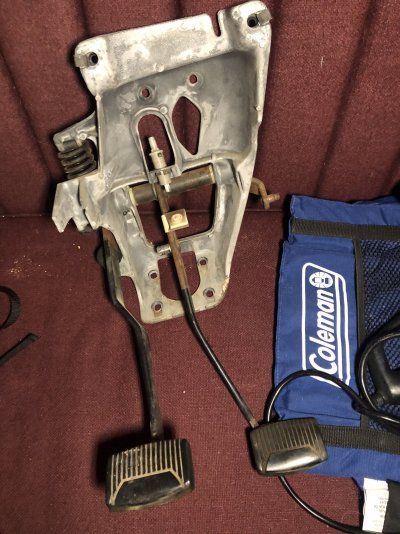

eBay unit arrived and got inspected today. Seems to be in alright shape, this truck must’ve had pretty low miles judging by the pedal pads. Was gonna replace the plastic bushings but these seem in alright shape.. will probably have to remove the clutch pivot foot to accommodate the heim joint anyway so would probably be easy to do while in there.
If I can find the bushings locally may as well replace them but only seen them online, any thoughts either way?

I have bought several sets from O'Reilly. They are in the Dorman help stuff, has been about 5 years since I have bought any though.

I believe I had looked into those when I did my last ZF5 conversion, some years ago. McMaster carries a bushing that is almost identical to them, might have been a little longer and needed to be cut down but they are cheap enough and readily available.

I believe you can get the bushing on Amazon too. I would at least take it apart and grease everything before you install it. Now would also be a great time to install a firewall stiffening plate, whether you make it or buy one.
My pedal bushings are worn, and I was toying with the idea of replacing them with oilite bearings or maybe needle bearings. Probably not necessary, but seems like a more permanent fix.
1,687
1,669
Yeah a few bushings are available
Firewall stiffining bracket
Do the Heim Joint repair when you have it all apart. You will have the shaft it all hangs on in your hands. The little bent bracket with the pin sticking out. grind off the back side weld, knock it out. Then after you install the bracket assembly, install the bolt and Heim Joint etc....
this way you eliminate the bushing for the Clutch rod.
They are likely too thin for needle bearings, although one could machine the bushing pockets open to accept a more robust bearing. There may not be a bronze or oil impregnated bushing made down to this thin of a wall either. The thinnest wall I usually see on those at this diameter is 1/16" which I believe is going to be almost double the thickness of the plastic bushings ford used. Dry running flanged sleeve bearings like these usually come in around .03125-.046ish.
There are some newer materials on the market now that could replace the OEM bushing and stand up to alot more punishment. I have used some very thin flange bushings made of a material called
Rulon J - Ultra high load and ultra low friction material. Stands up to quite a bit of punishment, temperatures, etc but its not cheap. Not uncommon to spend 60+$ per bushing of this size...
Alternatively just replace with the generic OEM PTFE stuff knowing that bushing probably hasnt been touched in the truck's life and will probably never have to be replaced again before the truck rots into the ground.

When I swapped in the Peddle Bracket from the 85 PNP one to the 86. I took it apart, wire wheeled the crap off the aluminum to pretty it up. Cleaned up the 2 levers to bare steel and painted them. Ford only paints 1/2 way, only what you can see. Kind of like an old lady with knee high stockings....
Did the Heim Joint Mod and installed the new Bushings.
Actually the old Bushings really didn`t look all that bad, but don`t remember the milage the 85 had.
One of these day`s I`ll dig into the one off the 86 with 300K + miles.
I agree the new plastic Bushings will out last the life left in the majority of what`s left of the fleet of these IDI`s still running around on the roads. So don`t really need to go high tech with needle bearings etc.... only if you want to.
