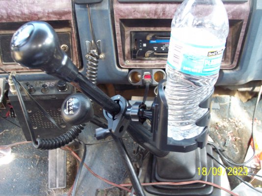

Ive got a feller going to give me an estimate on the cost of putting a clutch set in, for me. If all goes well it may be next month before we start hauling trailers again And I think Ill stop by Autozone and see if they have any cup holders on sale. Hard to drive a stick and hold a cup of coffee and drive at the same time.

What are the recommended number of cup holders for a supercab pick up. Ive heard the numbers range from NONE to 12......... I await your answer with bated breath ( or bad breath, whichever ).
