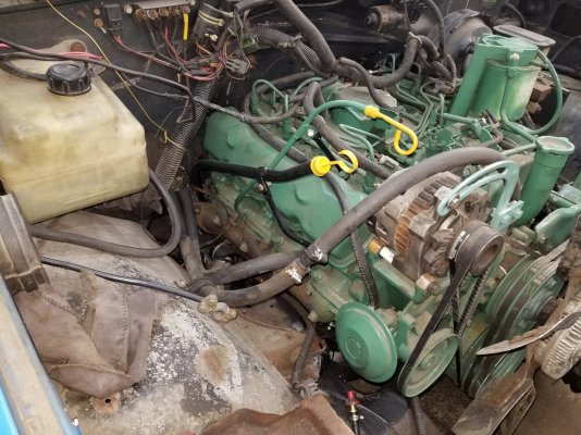

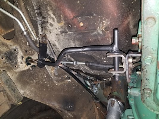

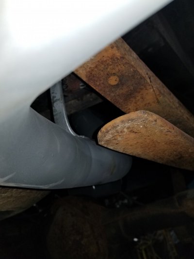

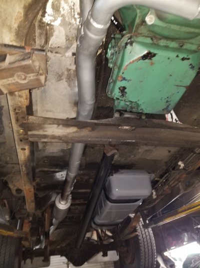

Been chipping away at this in our very limited spare time.
Still not settled on a radiator. Due to the chevy steering box location and the IDI engine fan sticking down so far a drivers side lower radiator port would be really difficult to plumb. So current plan is to use a Chevy radiator that at least fits right, and plumb accordingly. Still shopping around for a radiator with correct port sizes.
Other than that, fuel system is plumbed, exhaust pieced together, shift linkage adapted, dipstick tubes bent to fit and driveshaft installed (DS from the van was a direct fit so that's nice).
Any ideas on where to find a wiring diagram for the Chevy? 88 c2500

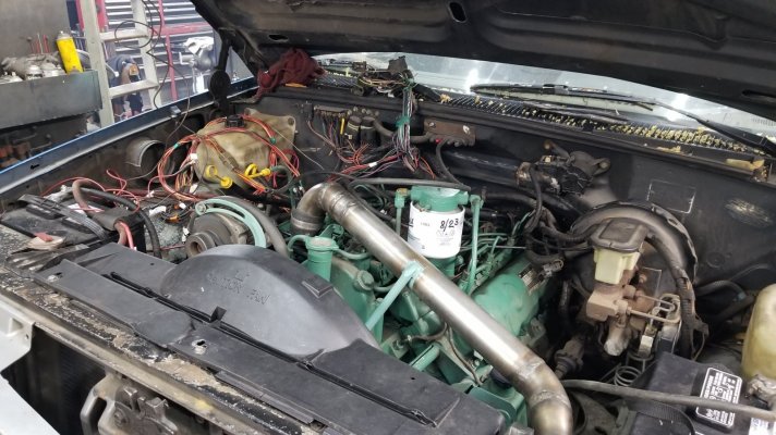

Going well, though working on it very rarely. Busy with other projects and other stuff keeps breaking.
Went with a late 90s chevy radiator/shroud. Which was obviously bolt up but had to make custom plumbing.
Otherwise just knocking around town with it and tinkering as we go. Straightening out what we need or don't need out of each wiring harness little by little.
Coolant, fuel level and voltage gauges are working well. Tried a few different senders for oil pressure but that's not responding. So may have to just go aftermarket there along with a speedometer.
Next big item is converting the front to 8 lug and going through the suspension and brakes.
