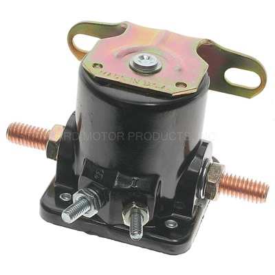

Take new one out of box...had a different mount bracket and the connections are different. MasterPro 2SS4

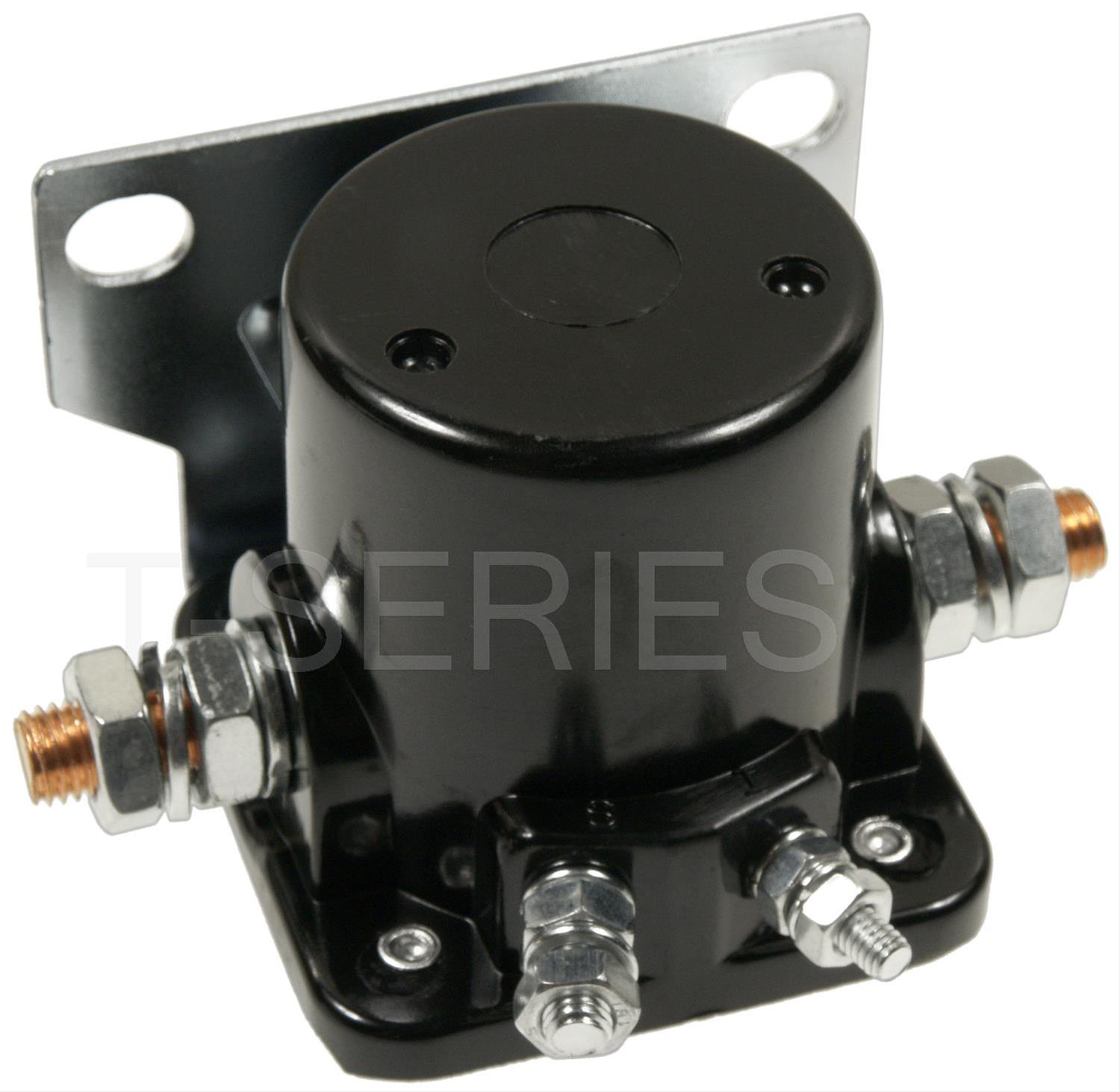

Old one has a "L" Bracket mounted to it and it bolts to the inside Fender Wall. One large + Stud points to the Battery, the other towards the Fire Wall and little ones towards Engine.
No way this new one will mount and not have to tweak the wires around to work.

So finally just search Ford relay and eventually find on Summit Racing one for a Mustang etc.... and eventually shows it is also for a 6.9.
Standard Motor Products SS588T $14.99, and ordered 2. TAX $2.98 and $11.99 ship. Total $44.95
Summit part# SMP SS588T

Brown dropped off my 2 Relays from Summit last night, and today got it mounted. The old girl came to life.
The old one was mounted on a "L" Bracket like this Summit picture.
The Relay bracket has been scaled down, (maybe cutting costs) to this type mount bracket where the relay hangs off it.
Bolts to the same hole`s on the fender.
I like this type as the big contacts for the + connections are to the sides.
