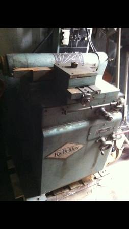

Did some searching and found a few on CL
I finally found one that is specifically for doing Flywheels.
pricey little sucker.
They are out there is looking, first time I searched for these.

I thought flywheels were ground on a grinding machine?
And I guess you guys know a flywheel for a T19 will not work with a ZF? There was a lot of discussion in the previous posts and it was a little confusing, you may have mentioned that already. You may have been talking about engine/flywheel compatibility and not transmission/flywheel compatibility.
That is correct, they are put in a specialty machine with a head bit that uses a cone shaped grinding material. We got off on a couple of tangents of other than flywheels why machine shops are disappearing. The flywheel grinder/surfacer would be a machine that looks like this the one old goat posted.
