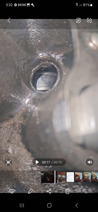

How does the corresponding cam lobe look? Any photos of it?
Pretty grooved now that I can see it from the other hole. I have the camshaft from the 6.9 but i havent looked at it yet and I have to be out of this garage asap. :/

Guess you get to push the truck out, that cam is hosed
Damn. Well that figures. What a saga lmao
On the plus side, it's a good candidate for a Typ4 cam core now.
Do i have to pull the motor or can I swap the camshafts in the truck if I pull the condenser, radiator, etc
I think that you can pull the cam by just removing the radiator. I think the condensor can stay, but don't quote me on that.

Sounds like I can definitely just do this in the truck and the time is now while the valley is still open and theres no coolant anywhere.
If this other camshaft is good and I go about swapping it in, what other things should I be on the lookout for while Im in there? I have the manual and will study it before moving forward for take down and reassembly, but do yall have thoughts or tips? Special tools I should have or need to improvise? Should I assume the camshaft bushings are trashed too?
