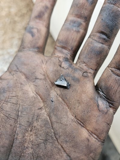

Anyway, yesterday I opened the valve covers to see what I could see since I had new gaskets for them anyway. On the passenger side, in a puddle of oil just below a pair of rockers, I found a pretty large shard of what looks like cast iron. It has a broadly round contour and is about 1/8" thick overall. I'll post a picture below. I have no idea where it came from. It doesnt seem to be part of any of the rockers and I cant see any damage to other parts on the face of it. Any ideas? It was going to rain and I didnt have time to pull everything apart so I put the cover back on.

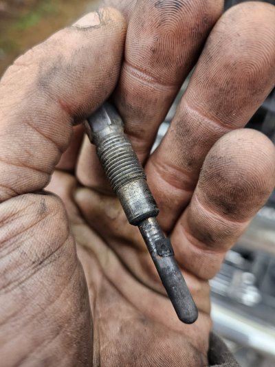

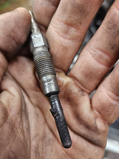

This morning, I replaced all 8 of my glow plugs. Seven of them came out and went back in smoothly, nothing abnormal at all. Cylinder 7, though, was different. Plug came out fine, but the tip had a little band of metal wrapped loosely around it. It doesn't look like part of the plug, but I dont know what it could be.

The piece around the glow plug kinda looks like part of the retainer spring clip from a sparkplug wire. How the hell it got on the business end of a glow plug I have no idea.
The cast piece I'm really not sure.

Not sure about the cast piece either. The part on the GP tip kind of looks like a male spade connector to me - maybe someone was doing some crimping repair and it fell into the bore somehow.

I would inspect every square inch under that valve cover, rocker arms, etc. It came from in that area so concentrate in that area with a bright light and a mirror. Don't be in a hurry. And that piece around the glow plug may have been a glow plug connector that came off of the top of the glow plug, fell in the hole and was forced on the element upon refitting.

Yeah, that's tough to call. The glow plugs thing could have been dropped in the intake. Neither item looks familiar.

Thanks for your thoughts, yall. The glow plug part seems to make sense. Glad it didnt come unwrapped in there.
I guess Im going to open the valve cover back up and do a more thorough inspection. That shard would had to have come from something on the top side of the valvetrain, right? Nothing could have made it up there from anywhere else in the engine?

As far as that chunk of cast metal...it came from somewhere...most likely some area that has a stress to it...I know that is kinda elementary...but without seeing the whole head topside...can't really say...as well as the bent tab on the GP..? Now that is strange...

And yeah, unless a previous person left that piece in the valve cover, or it fell in there while you had it open, it has to be from under that valve cover.
