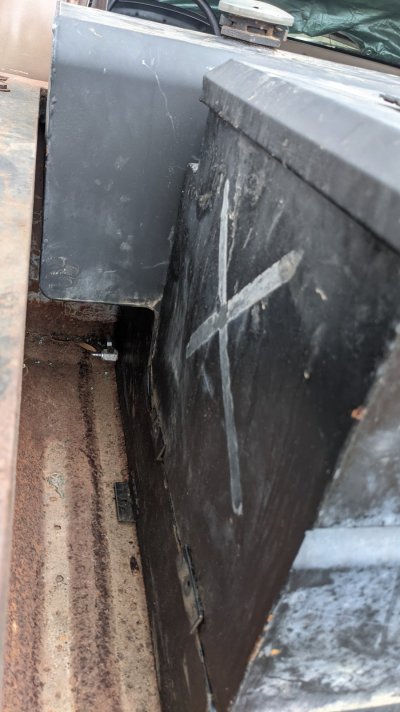

Ok, I have my hard adapter. Now here's my next problem. Trying to run the return line to my aux tank, how do I bolt it on? It's a nut on one side, so I can drill it out, but I can't get my arm to reach in there! Only thing I can think of is using a grinder to cut out a square, then bolt it on and weld it back up. I don't know how to weld though....
Dang, any idea on how to get it on?
