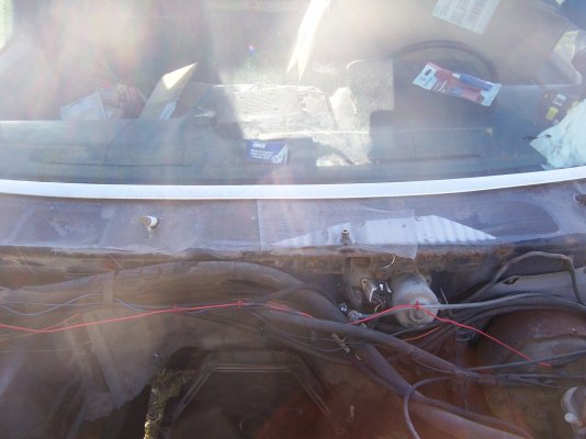

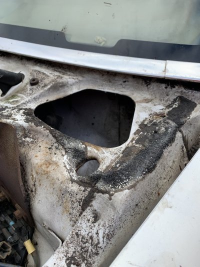

Once cleaned out, I did a quick dish soap and water white bristle brusk to the entire area. One thing that has me baffled are the two plastic plugs that only appear on the passenger side of the cowling. I am assuming this is to keep unwanted debris out of the outermost firewall area as I believe this is where the cab draws vent air. What I don’t understand is if there was supposed to be one in both sides. See pics for better explanation, but it doesn’t appear that there was any cover over the drivers side holes for many moons (if ever?).

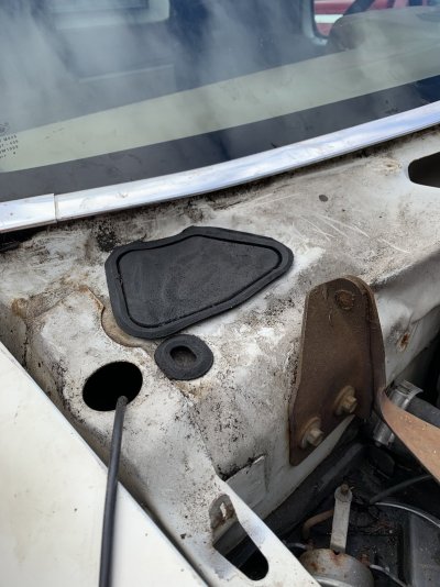

I had that all apart Sept/Oct of 20. Had Windshield out to clean out the area it lives in to get the Sealant and Rust removed etc... then a new glass installed and sealed.
I had the Cowel off also to clean out everything in the Air Box area (what I call it) to clean out all the old Seam Sealer etc... and re seal it.
I took pictures of everything as I went along.... but on my old phone, soon as it is recharged I`ll see what rubber covers/plugs there is.

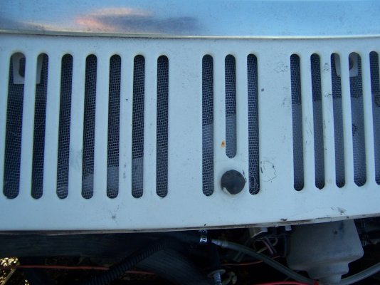

This is on my 86 f250 which had the Cowel with the large slots. I got one off an 87 with the small holes, had it sand blasted and then painted it.
Yeah a lot of crap can get down in there. Mine wasn`t too bad.
Where the water drains out behind the front Wheels, behind the fender Liner are a Rubber Duck Bill drain.
Crap can build up behind it.
Once you pull the liner forward you can see them, good luck removing them, they have 4 push pins that hold them in. I tore the rubber a bit getting them out. Just let them open, now I suppose Mice have a good access to get in.:frustrate

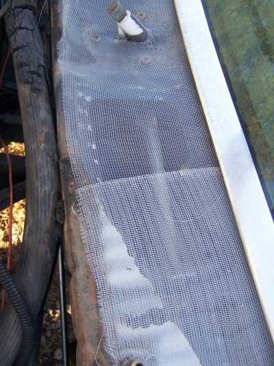

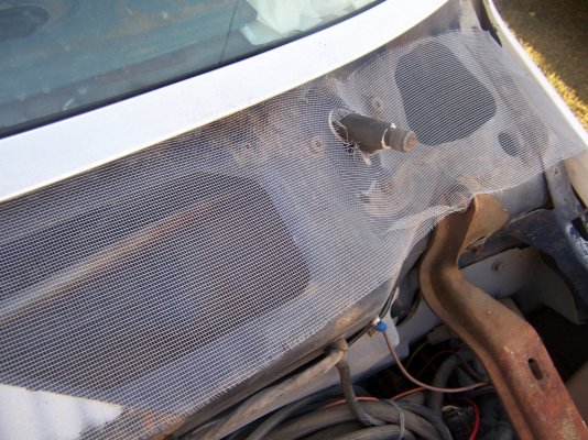

I did the window screen trick to my Blue Truck 2 years ago and I have to say that it's NICE to not have leaves blow out the vents at me. I used the aluminum screen. My thinking was that it won't rust and it will (should) last longer than the cloth stuff.

I looked at the pictures on my old Phone, and I didn`t take any pictures of when I first removed the Cowel Plate.
I know there were a few plugs and covers I removed.
I have the Kick Panels off my 86 and my 85 right now, I`ll take a look to see what access covers you are taking about Tom.

So in this pic: it doesn't look like there's any plastic plugs on the driver's side.

I didn't look when I posted the pictures, but it looks like you're right. I plan to do this to the Red Truck someday. I may even do it to the Ex Wife just because.
