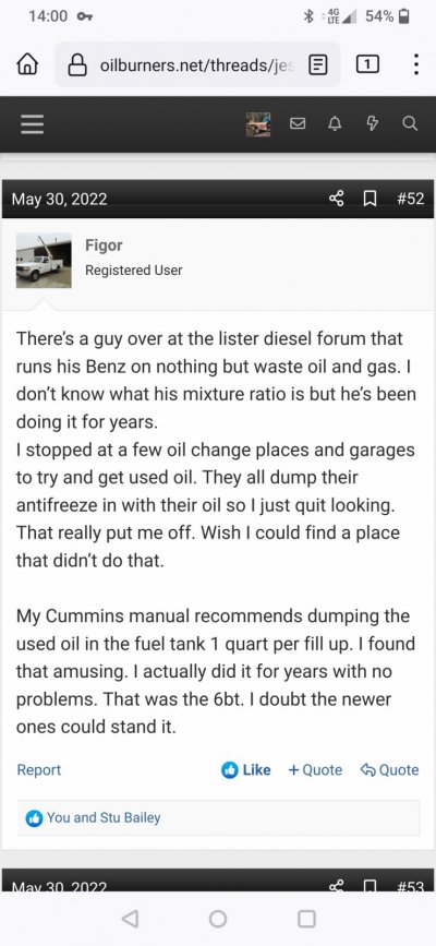

In my WMO thread, I believe it's @u2slow says that the original 5.9 Cummins owners manual actually recommends pouring your oil changes right into your fuel tank. I'd do it without hesitation since you just run diesel. As a whole hearted WMO burner, I'd just pour it in my collection tank with everything else.

Look at the screenshot in my previous post, Cummins recommended 1quart per fill up.
