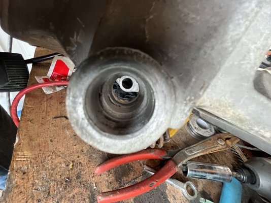

I’m not sure how helpful it is, but here is a photo of my slave cylinder travel on my ZF-5. I have a video, but I don’t see a way to upload it so hopefully the pictures give a good idea.
Thank you! Yea you have to upload videos to YouTube first to be able to have them on here which is stupid, it appears to be that I have enough slave travel
Looks like sufficient movement. Are you sure your clutch disk is installed the correct way. I seem to recall some issues about no working if installed backwards.
The clutch was installed correctly, it did work great for 2k miles
