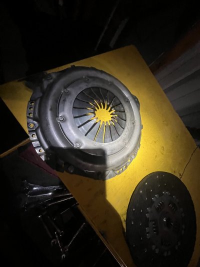

Alright so I went c6 to t-19 a couple months back and 6k miles ago when Thursday for the life of me I couldn’t get the clutch to disengage
Since the slave and master where new when I did a clutch (luk) 2k miles ago I figured good place to start so I warranted them both back to square one still nothing
There is virtually 0 firewall flex the pedal feel great which is the weird part
The clutch line looks good from the outside I did order a stainless line from Russ that will be here shortly

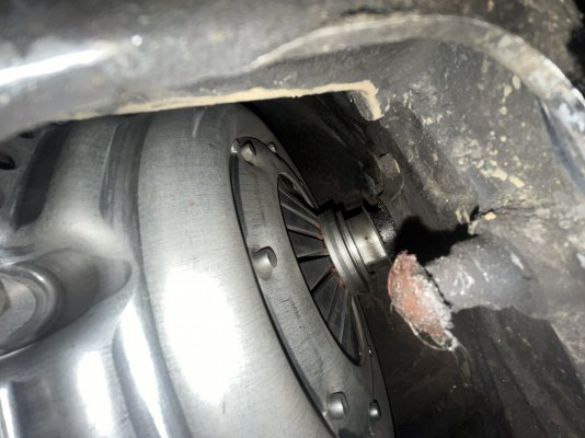

I did weld the the clutch fork so I pulled it to find nothing as far as that’s concerned
I videod the slave while pressing the clutch and it’s just about 3/4” travel on it

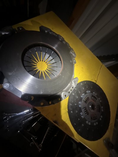

And then I noticed the tongues on the pressure plate where like that of one that’s not torqued/ out of the vehicle which raised my suspicions
With it being a 2wd t19 there so easy to pull so I yanked it out to further investigate and that’s where I am at now
I can never seem to catch a break when it comes to transmissions with this truck atleast it’s better than a blown c6

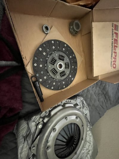

Last pic is what it looked like out of the box not a new picture
What do y’all think?

Is the bellhousing cracked around the clutch pivot somehow that maybe it's not obvious and the bellhousing is moving and you don't see it..... maybe?
Rdnck84_03
Jan 15, 2019
1,149
1,230
Kansas
Not likely this is your issue since you already swapped the master, but do you have the adjustable push rod? If so did it come loose?
Look up inside of the pressure plate for a break in the spring around its outer edges, usually happens at a rivet hole. If it is broken the plate will disengage crooked not allowing it to completely release.

I would inspect the diaphragm in the pressure plate closely. I had one break years ago on an 80's Malibu. I must have pulled and installed that transmission a dozen times before I finally found the problem.
As I am not sure what your repair was I'm just grasping at straws here. Is it possible the clutch fork could be bent, not allowing full disengagement. Or possibly flexing.
James
It snapped, I’ll take a pic when I get back home
