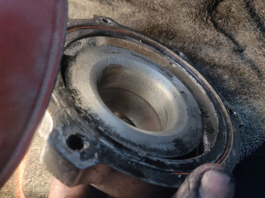

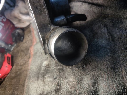

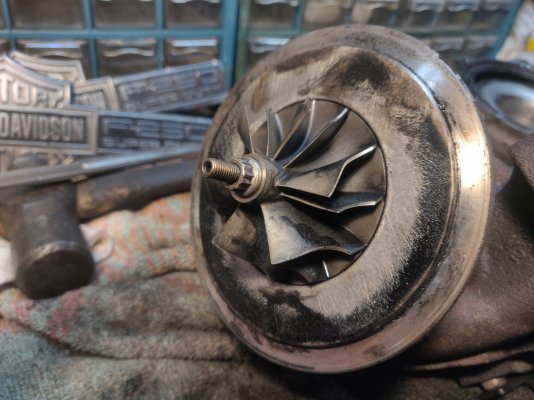

Alright, I pulled the turbo today. Brace yourself, I'm about to say something positive about Dodge...........at least they put the turbo in a place that you can reach, alright I'm done.
So it's pretty oilly on the compressor side. Does this look bad? I don't know anything about it. I can't get the exhaust side off and I'm scared to beat on it any harder than I have.

I was using @2gals of oil to drive @100 miles. At that extreme usage, it seems like it would be wet on the exhaust side......I think.

Since the crankcase vents into the air intake, it's not surprising that the turbo is oiled like that. I'd say it's normal. As for oil consumption, hopefully it's not a broken ring. Had similar symptoms on my dad's non-turboed idi, turned out to be a broken ring.

That turbo has a lot of scratches on it... quit feeding it dirt! Looks like the compressor is kissing the housing. Mine did that when I first got it, needed a new CHRA or a rebuild. I got the CHRA cause it was much faster and I needed a quick turn around. But better to send it to Russ if you have the time.
How much boost are you getting? That's some ridiculous oil consumption!!!

I don't have a gauge or anything. I know I'm going to have to pull the heads, I have a suspicion there's cracked pistons in there. Probably won't do a turbo.......$$$$$..... and that stuff is hard to come by. If this turbo motor want $$$ I'll spend it on my other blocks and send this turbo stuff to one of you guys that's more into it than I am. It's neat but I just need a machine that can crank up, run, go, and stop. The turbo has been nice!.
