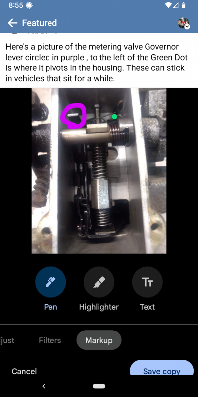

I hope you don't mind, but could someone tell me where to find the metering valve? I can't imagine where I could find that one?

Use Stanadyne blue label, its designed for lubricating these pumps. WAY better than ATF.

Hi Russ, thanks for the image, but that product, I'm not sure If I can find that over here.
though this metering valve, if it sticks, the result is that you can't change rev's? it stays on the same number of Rpm's?

No it wont fuel at all. they should have some diesel additive available.
