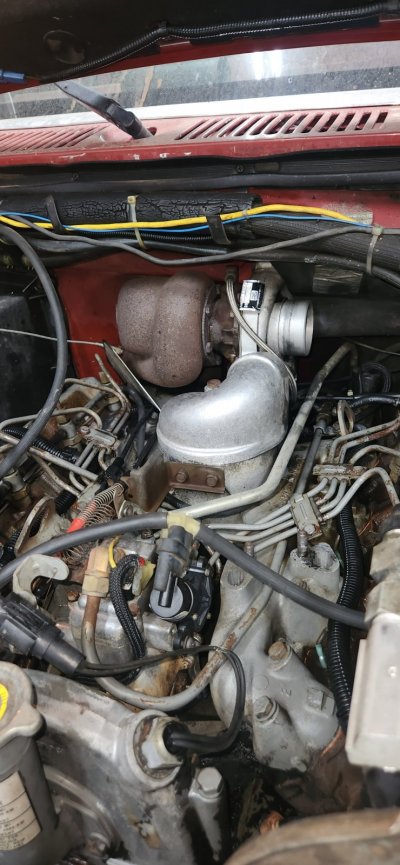

We've had this old truck on the farm since new. Was my fathers and hasn't been used much the last 20 years only has 102,000 miles. Lent it to my brother for a few weeks as he needed a vehicle. Said one day at work he started it and it idled real rough, smoked terrible and low power. I told him to park it and now I got it in the shop checking it out.
It has a turbo on it too my dad had put on in the 80's. Checked basics and took for a spin no visible leaks. It has NO power barely makes it to 30-40 mph. Smokes REALLY bad. Air filter was dirty replaced it, checked turbo its spinning, exhaust is ok ( needs new exhaust) . All original injectors and injection pump. I was gonna replace the fuel filter next here but got to thinking the way its smoking (over fueling) its getting fuel. I took an infrared thermometer and checked exhaust ports after I took it for a spin. They all seem pretty equal like no dead cylinder.
Do these injection pumps fail like this ? Something gets stuck in them?? Called diesel shop that originally put the turbo on that's still in business but the guy there had no idea said it was too old and they don't see these trucks anymore and no longer rebuild the pumps due no parts. Said to check with the parts department and see what they can do. Anyone seen this issue ??

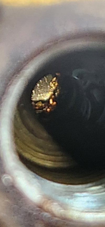

Ppulled
Does it start smoking right away, or after things warm up? I am thinking of a possible bad oil seal on the turbine side of the turbo. Putting oil into the exhaust stream that is burning off causing the smoke. Turbine is coked up and not generating enough / any air flow on the compressor side, and hence the low power.
Pulled off the check valve/regulator on top of the pump. It's not functioning correctly it seems. If pressure builds up in in pump housing things don't work correctly from what I've read. There wasnt like sediment or stuff stuck in there but a film of gunk or something on the glass ball. Carb cleaner helped some. The ball doesn't move. Soaking it more.

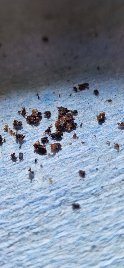

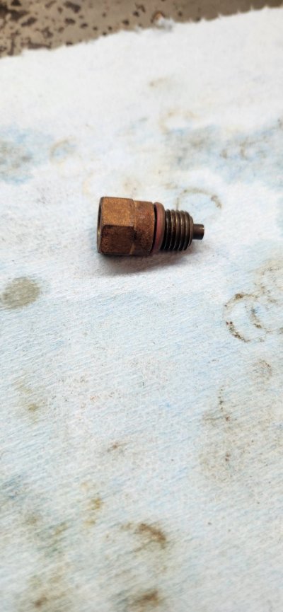

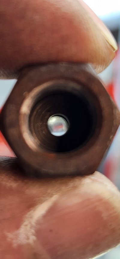

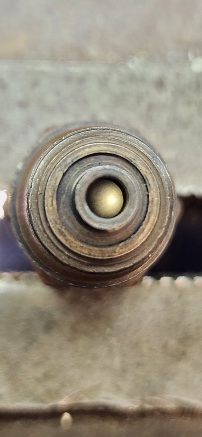

Well its back working again as normal. It was the check valve all stuck.
I put the valve in the ultra sonic cleaner in varsal from 20 minutes. That loosened the ball and spring up. The spring was packed with like a varnish stuff. It didn't look rust or metal sediment. See pic. I was able to pick and blow the stuff out of the spring down in the bore of the check valve. Now the ball moves correctly. Thanks for the tips.
