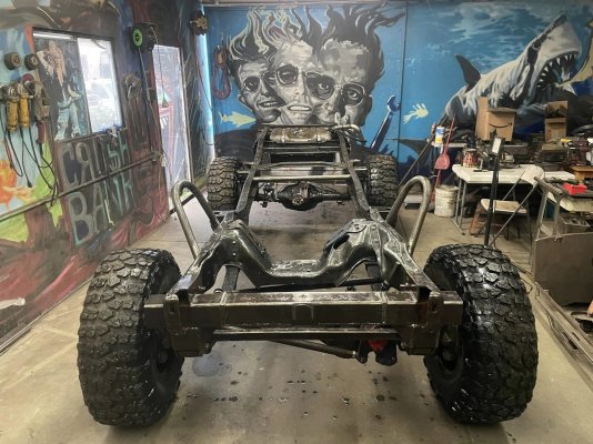

super duty axles are what i would buy.
you can buy the cheesie bolt on RSK or make your own
i make all my mounting
