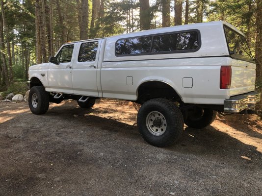

Howdy folks..it’s been a little while since I’ve posted here.
But I finally got my motor swap done this spring and I went all out replacing injectors, various pumps, seals, flex plate, steering gears..on and on while the motor was out. Even having the radiator flushed and painted. I was thinking I’d keep this rig till the wheels fell off. I have a 94 turbo idi with a 4” lift and minimal rust.
But I took it to pick up a small tractor and it’s really a dog towing and it’s not comfortable to tow with either..I’ve got kids and love that I can bring them with me when I need the truck but for the most part it just sits. While towing the trailer I was coming down a hill and it was super sketchy and the brakes wouldn’t stop me. I’m lucky that I was able to make the turn with no cars coming otherwise I think i would have wrecked with tractor and trailer in tow.
So my dilemma is do I go through the brakes and rebuild the front axle..possibly swap in DRW axles from a 97..or do I just sell it while it’s good and strong running. I think a flat bed dually Crewcab would be best for work.

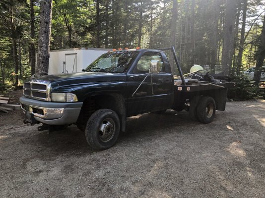

I’ve got a 1999 24v 3500 flatbed 5spd that starts every time and I have a few grand into it. But it needs just a few items to be a runner..It may need a bunch of random parts if I start Daily driving it but it’s a rugged truck compared to this 94.
One other major concern I have is what about the wiring harness? On some of the large connections have slightly corrosion starting on the visible wire ends that go into the plug. Does this mean I’ll have to rebuild my whole harness DIY in the future?
I really like old mechanical motors but if the wiring shorts out, or if the motor blows again I’ll be pretty bummed and just don’t want to keep dumping time into it..I live in a rural area so having a slow old rig isn’t a big deal but what if I want to tow a camper across country..parts weren’t the easiest to find.
Anyone else go through this line of thought and what’d you end up doing?

So to get the dodge road worthy..
Things I know
-Exhaust (not needed but could use it)
-Couple brake lines
-Rebuild calipers (both trucks need that)
-Maybe a couple tires
- windshield
-finish welding new floor
- fix the 4x4 actuator
- there is a slight haze at idle..maybe an oil seal but otherwise solid motor I’ve only driven it 100 miles around our property over 2 1/2 years
-batteries
So that’s the list..maybe rebuild the front axle as the u joints look a bit worn but it’s not leaking like the ford axle.
The pros of the dodge would be setting aside perhaps 10k from the sell of the ford. And letting the salt eat the truck I bought for $1000. I’m guessing the dodge could use $2500 in parts if I went through it..I’d have $4500 into the dodge once on the road.
I guess the other thing that’s got me thinking is when I did my motor swap it took awhile to find a decent turbo idi motor. And who really knows if it’s solid as I’ve driven it 1k since the swap. The tranny has been rebuilt before I bought it.
I’ve also thought maybe fix up the ford..sell the dodge and slowly prep for a 12v manual swap into the ford..that with tow mirrors and a drw. Flat bed I think it’d be a useful towing rig. I don’t tow like I once did now that I have my van for work.
But given the uncertainty of the economy im tempted to pocket some cash and not drain it into vehicles anymore..but I do need a 4x4 tow vehicle once in awhile

So here’s my opinion: the lift and big tires are really hurting you regarding towing. The “doggy when towing” is all relative: I pulled my race car over several passes in a normally aspirated IDI. Was it ideal? Nope. Did I spend a lot of time in third gear with my foot to the boards until the crest of the next hill? Yep. If you know the route you really learn to run hard and build some steam before the steepest grades. But I always planned accordingly and made it on time.
Now for the important part: braking is super messy with a lift and larger than stock tires. You absolutely need to consider hydraboosting your brake system as the vacuum assist of IDIs is :fan: If you cannot lock the wheels on your truck, you don’t have enough brakes. You could also consider rear disks, but the majority of your braking is going to come up front. I’d go hydroboost and put the best severe duty pads you can get your hands on the front calipers. After that, you can consider going dually rear axle, but I think a hydro boost master cylinder will make your braking system far more capable.
