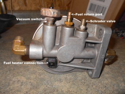

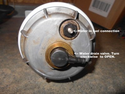

Here ya go.
In Bill's pics the vacuum switch is not the dash low vacuum switch. That vacuum switch is the tuna can looking pot usually located on the passenger side fender well. This vacuum switch bill is pointing out tells you your fuel delivery to the injection pump has just become a vacuum and not enough fuel supply is reaching the injection pump. In my many years of owning my rig only once has my dash fuel light ever come on. and that was when I was really asking the engine to lay down some power. Even then it barely lit up and as soon as I got out of the throttle it went out. I had a Fram fuel filter on the engine when I purchased the truck. You bet I changed it too. Now after nearly 300,000 miles I still never see that dash light come on. I maintain my engine so it will not be an issue some late Sunday night on a dark road miles from home...
