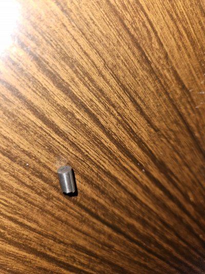

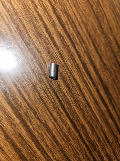

Found in the bottom of the oil pan while doing an oil change. 92 E350, N/A, runs good. No noises.
Lifter parts? The mech fuel pump has been deleted and blocked off, so not from that.

Maybe a locating pin for the front or rear cover plate? Otherwise, I'm out of guesses.

Ever heard of killer dowel pin for a 12 valve Cummins? Wonder if a disturbed cover can cause something similar on these engines, falling below etc.
Could have been worse if that’s the case

I don't remember exactly the killer Cummins pin is, but I don't think this could happen to an IDI. I think it would go to the bottom of the sump and stay there. I don't think that it could be picked up into the oil pump.
The killer dowel pin can do one of two things, fall down into the oil pan, or the timing gears. They cannot get picked up by the sump as the sump has a screen
So now I know that this can't happen to a IDI. The Cummins killer is internal, or at least under a cover so it's not exposed internally. It can fall out while the engine's running. The ones on the IDI are exposed externally and can only fall into the oil pan when the engine cover (front or rear) is removed. Either way, the engine's not running.
