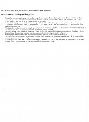

Hey '79....thanks for the specification. That's exactly what I needed to see.
Warden, In my wvo system, I'm going to replace the stock lift pump (I think) with an electric one. It will give me the advantage of being able to turn it on/off. So, it appears I need an electric fuel pump that provides 18-20 psi max. Actually, I'll be running a pressure regulator, so any pump that provides 40psi or so I could regulate down to the correct psi. On the wvo side, I need a pump that will reliably pump 180* fuel all day at about 50psi +-. Almost all of the pumps I've seen are for 500-1000hp trucks or race cars and are too large physically for this little Benz, not to mention a several hundred dollar price tag. If you guys know of any smallish, quiet pumps that can do this, please let me know. Thanks!:Thumbs Up
