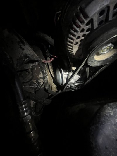

Austin86250
Oct 5, 2021
839
486
idaho
Replaced it with a new napa pump hopefully I get better luck than I hear about the pumps part quality
I painted my pully and bracket and put them outside since it was warm and sunny 2 hour nap later it was raining… oh well
Power brakes still aren’t very good I guess booster is next but atleast I’m getting good vacuum once again
