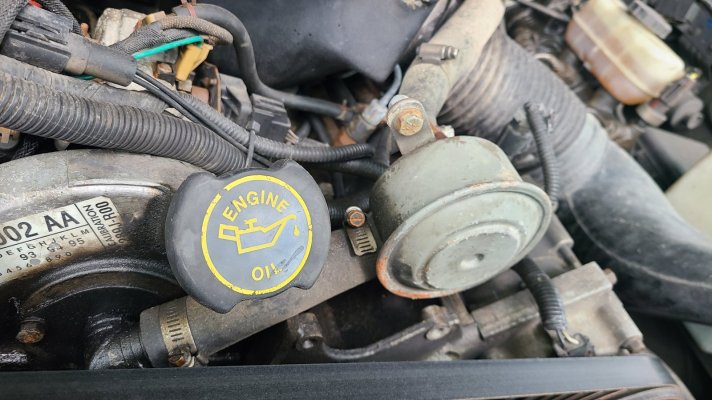

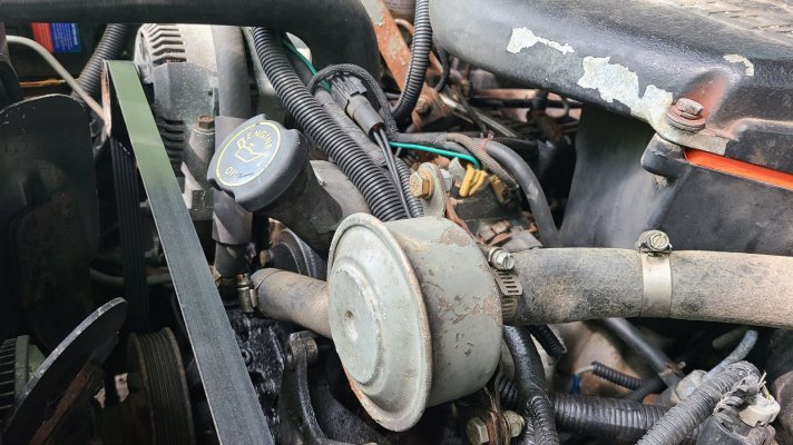

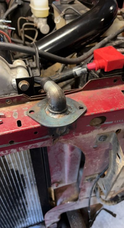

I made my own unconventional installation - first I welded up a modified IP cover to accept a hose, second I replaced the vacuum pump with an electric making room to install the CDR where it was. I will reply with pics.
This might not be as applicable to yours (v-belt) but might give you some ideas.

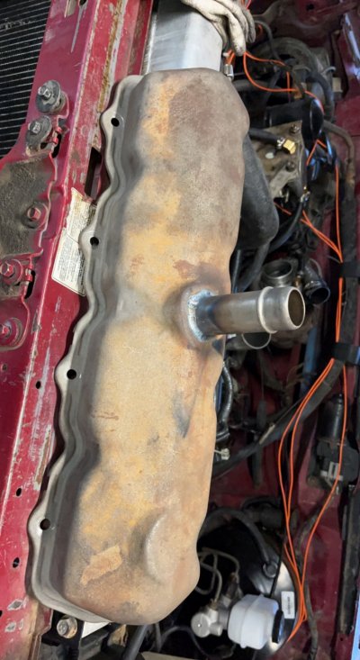

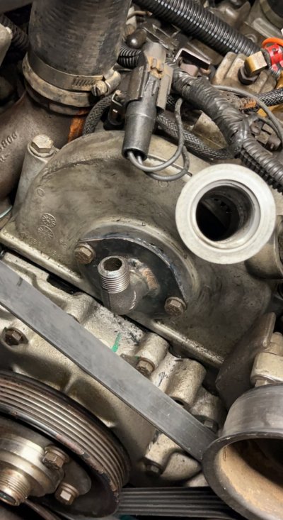

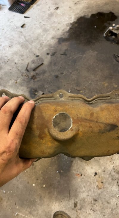

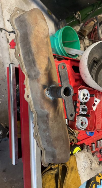

Just made this one yesterday for a 7.3/zf5 that I’m turboing.

You are taking the fumes from both Valve Covers and the Timing/Gear cover, then where are you sending it to?
