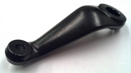

@1mouse3 post up a picture of your pitman arm, im wondering if it isnt still a dana 50 pitman arm. Because I have driven a truck with the wrong pitman, and the turning radius is just as bad as a ttb axle, But for me the difference was night and day, with a d60 and the right arm, Even my wife noticed how much tighter it turns

Im using this 3in drop pitman...

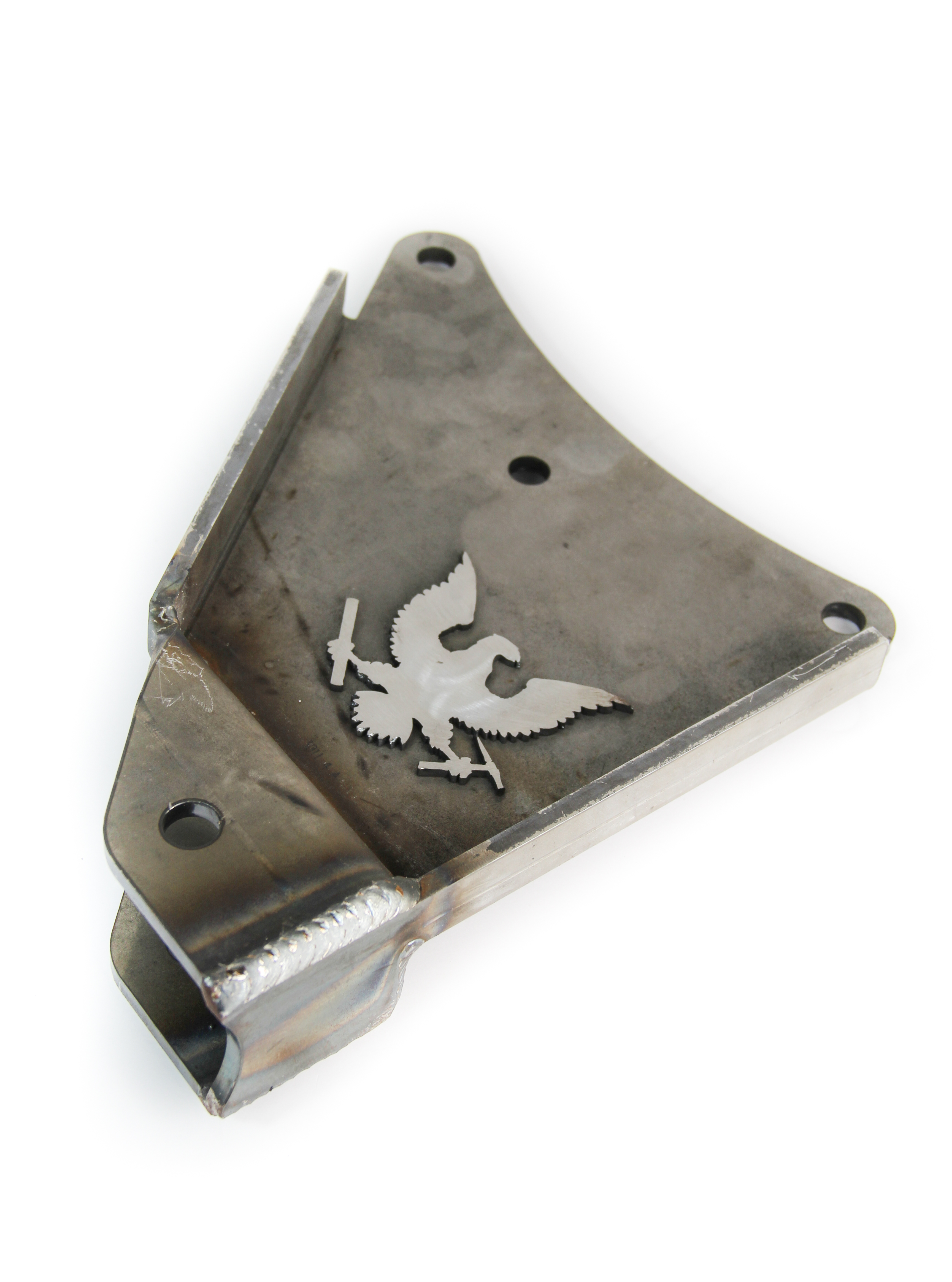

With this 3in drop for the track bar.
This is pics of the steering parts and I do get chipping pain from the stops, so think it makes a full turn.
