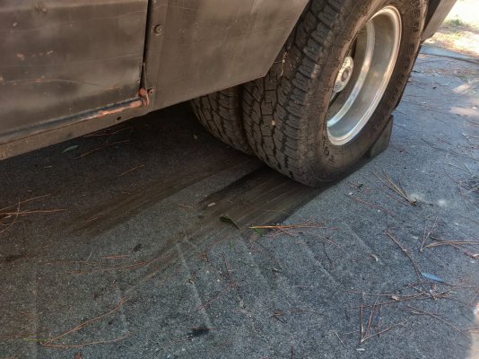

I exclusively buy tires at the junkyard. I can usually find pairs or sets less than 2yrs old for $25 a piece. I like the way 245/70/16s look. They got "the look". 235/85/16 are "correct", but don't have "the look"!
This is the only picture I can find of my Toyos on the tow truck. $80 for the set(4 tires) the 245s don't touch...... and just look at them! They look great! I might prefer a white letter though.
EDIT: Mine are LT245/75/16, I got 70 on the brain!

Because I'm all about "the look", I wouldn't like the height of the 80 or 85. The 75 gives me the "subtil low squat" look.
Hey @bulletpruf , mine are 245/75/16.
