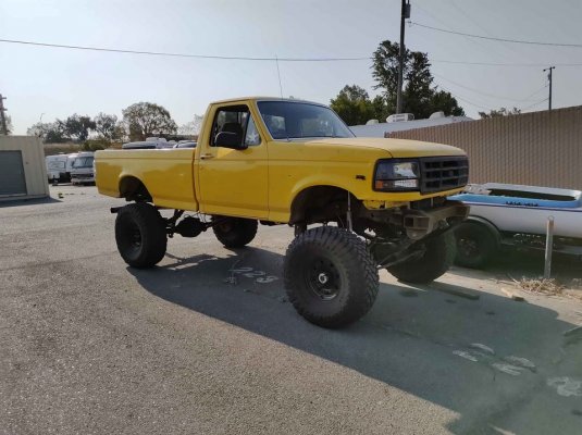

i highly advise a reverse shackle kit. DIY is better, but can be bought.
