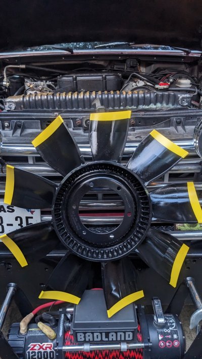

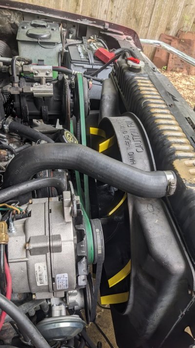

Yesterday I just finished up installing @03wr250f 's upgraded cooling fan, as well as putting a stronger electric pusher fan on the condenser as the old one bit the dust. Ac definitely feels a bit colder now! And I went and rewired my custom side markers so they also function as turn signals now.
Also I painted the fan blade cause why not! Haha

Thomas87
Oct 23, 2021
52
35
San Marcos, TX
@DrCharles , I would guess maybe a boost leak somewhere. The smallest leaks are virtually undetectable and can make a difference of a few psi. I had a slight leak out of where the pressure chamber meets the intake. Only noticed it cause it was always a bit oily, but didn't make a sound. Replaced the seal and brought it up about 1.5 psi
