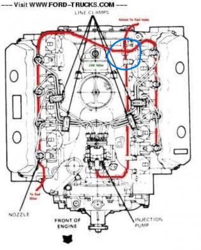

Still trying to find the source of air intrusion. O-rings etc all replaced. New return lines..... When I leave the truck for more than a few hours there is air trapped up in the air filter - when I bleed it only air comes out for a while.
My question: The steel return line connection which is circled in the image (sorry I don't know the name) - this is very wobbly and loose on my truck. Should this be nice and snug? Wondering if this is a potential source of air getting in.
Apologies for the bad quality of the diagram - it's the only one I can find online.

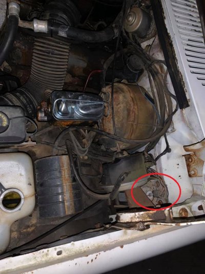

this is #1 source of air intrusion on all factory trucks pre 1988

more importantly than anything else thats been asked of you.
does your 86 still have the water/fuel seperator?
No! It has an after-market one. Thanks. I've heard these are often problematic.

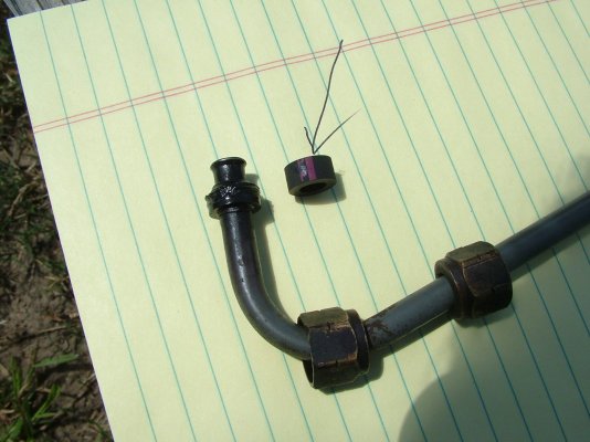

You seem unsure about olives. I've found that pictures often explain things best. Below is a picture of an old olive, on a hard line, and a new olive beside it, waiting to be installed.
