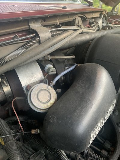

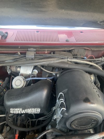

I don't know about a '91, but the Banks conversion for my '85 relocated the oil pressure sender unit to the top of the turbo. That introduces even more error to the OEM oil pressure sender because the new location is measuring oil pressure at the turbo but there is line loss caused by oil flowing through the turbo. Pressure readings there will be lower than main oil gallery pressure. In addition, the OEM Ford sender unit is not very accurate and wanders even when at its best.
I found an unused 1/8" pipe plug in the main oil gallery down on the driver/ left side of my 6.9 and plumbed a 1/8" copper tube up to the firewall above the turbo and mounted the oil pressure sender plus a mechanical gauge there. Now I know my 6.9 has 20 psi hot idle, 55 psi at 2,500 RPM.

Thanks for the message. My truck also has the banks conversion.

Another common issue is just that the connection has high resistance. Try wiggling that connector and maybe squeeze it a slight bit to make is tight if it not snug already. If that doesn’t help, these trucks have a big round bulkhead connector on the driver side firewall. All the signals pass through here. You can disconnect and reconnect this several times to clean those contacts and then again at the back of the instrument cluster there are two plugs that carry these signals. They can also be unplugged and reconnected to help clean those contacts. I’d rather fix the actual issue than have to know it’s ok to ignore a warning light.
There's another connector that signal passes through I forgot about on the passenger fender liner. That's the main engine harness connector and it gets dirty too. Unplug and reconnect it several times as well and make sure the heavy yellow wires that are at one edge of the plug haven't over heated and melted anything. It's important to clean and protect these connections from corrosion with some dielectric grease as they carry all the current to your glow plugs system and need as little resistance as possible. In fact it's better to take this load off this connector by running a separate dedicated heavy gauge cable to the GP solenoid routed directly from the starter solenoid where the main 12V distribution starts. Ford made this change in '92 and it's for a good reason but I don't think it's a high priority until it starts getting cold this fall.
