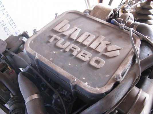

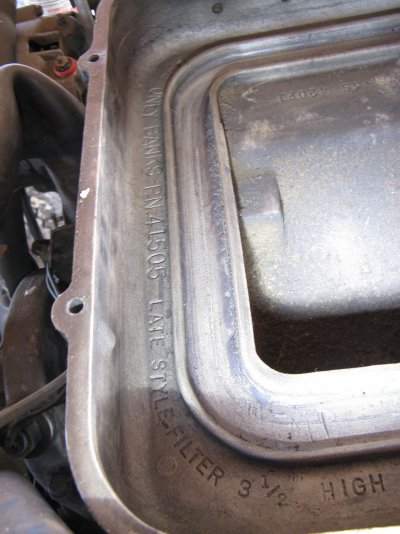

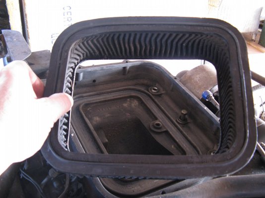

Banks used both filter sizes. I have a complete engine and trans in the barn with that turbo. Filter pn# is cast right into the housing. The ones I found on internet are pricey. Surely there's another similar filter that fits and less expensive.
Claybreaker 144
Jan 7, 2022
Statesville, NC
I had a Sidewinder for a 6.2 diesel and found the air filter part number cast into the house was incorrect. After several emails to Banks I was provided the correct part number. I was really surprised. This was 10 years ago and I sold the motor and turbo a couple of years ago and provided that documentation from Banks with the motor.
