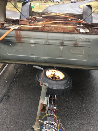

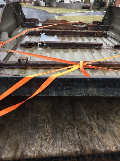

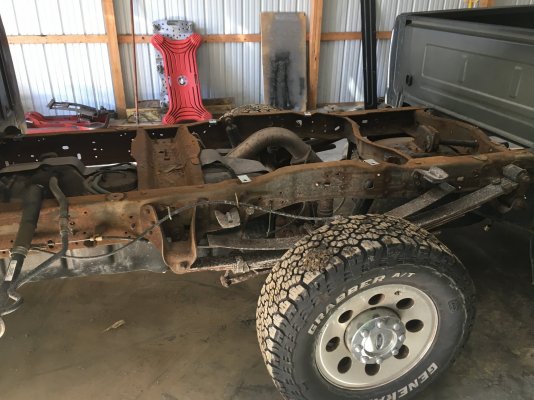

a couple of weeks ago i went down to Peach Bottom PA and bough a great conditon green and gold bed for my truck and got it installed there too. matching colors and the bed has had line-X sprayed in it. the guy bought it off of said that the bed came of a 70k mile old man truck from southern maryland.
it was also the longest drive i did in the truck and it was my first time towing a trailer.

Old cross rails were rotted
